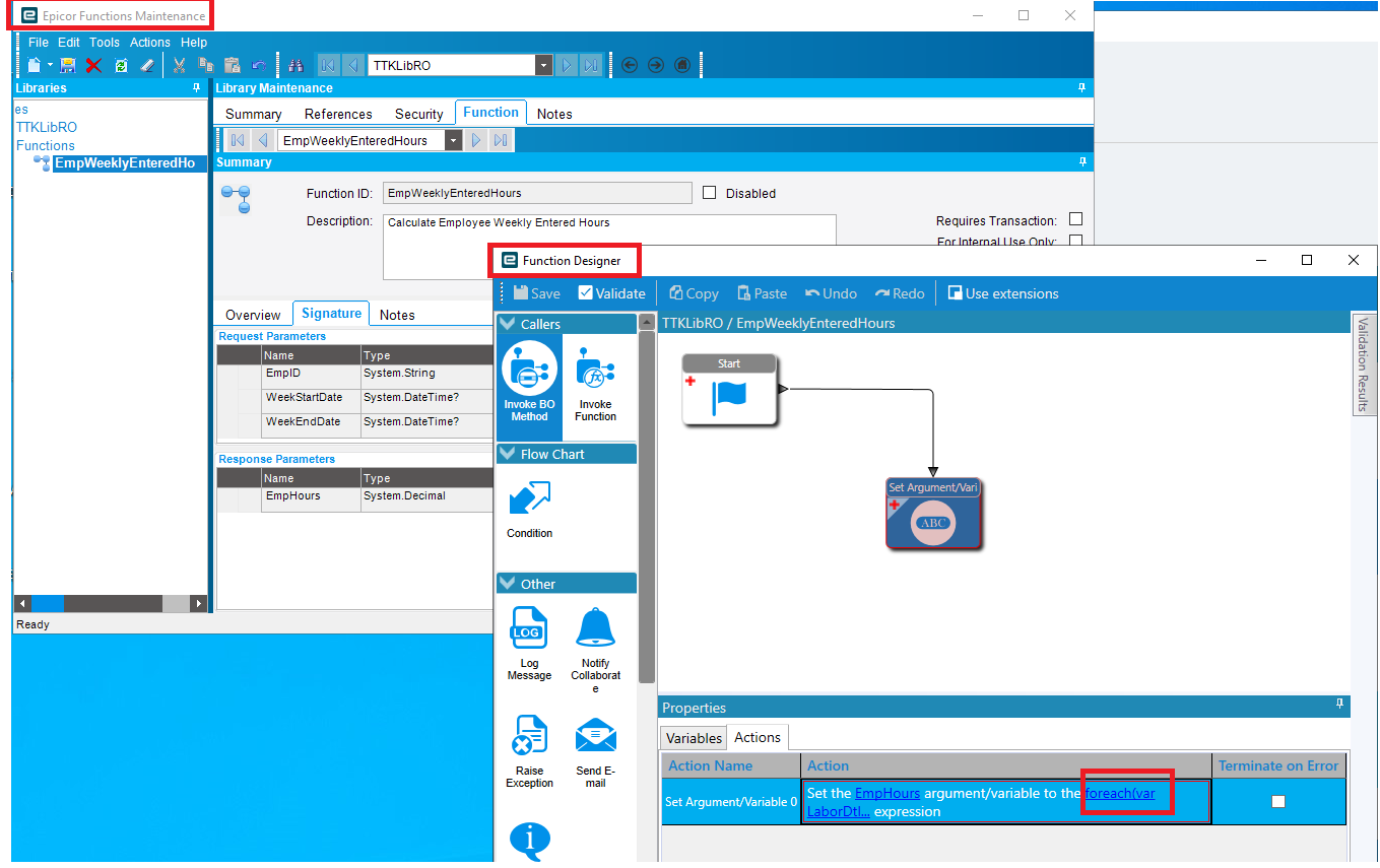

Hi Group,
I am writing a Epicor function where I am passing a EmpID, StartDate and EndDate as a parameter. I need to return the SUM value of the LaborHrs column from the LaborDtl table by ranging on the EmpID and Date range. Please see the attached picture. Can someone help me writing the C# code or if any other way of achieving this.

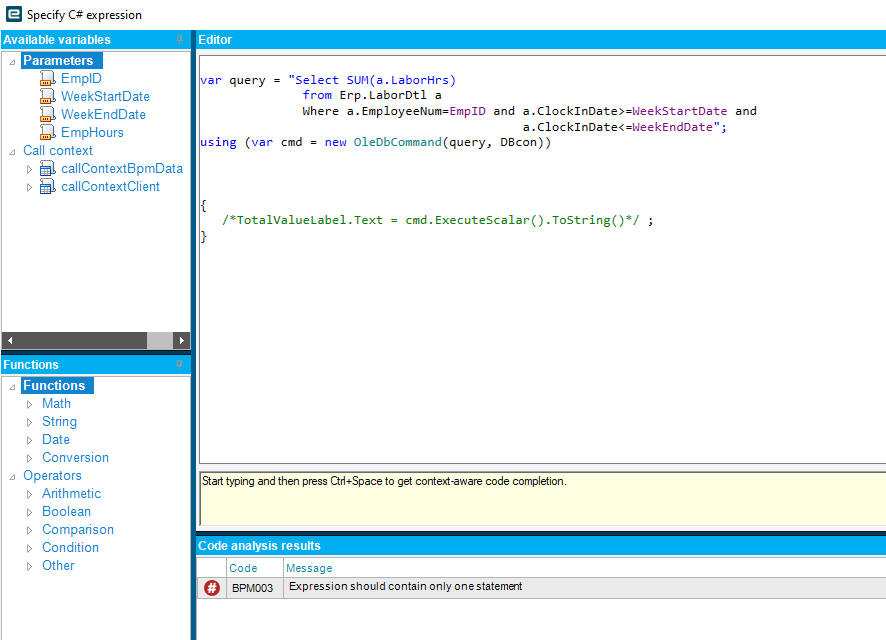

I can write the SQL but again writing s SQL within C# would be a challenge for me. Currently I am investigating how to achieve this through BAQ. So far didn’t found a direct example.

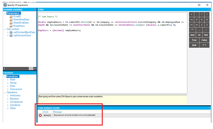

but my LINQ query is not complete and not working. See attached. Can you help refine this.
That is true - the widget you have (Set Argument…) is a one-liner.
For a block of C#, you’d need the Custom Code Block widget.

So, if you want the compiler to put the values of WeekStartDate (etc.) into the string, then you have to concatenate that together. As is, it’s going to read that as the string literal of “WeekStartDate”.
@JasonMcD That is how you would execute a sql command in a standalone program which is not how Epicor needs it.

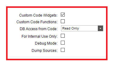

As Jason mentions you need to check custom code widgets and yo will need read db access.
IMO you should always pick Add widget with Code, so you can use either as needed.
Here is my setting:
But still getting the error:
As @JasonMcD pointed out you need to use a custom code block. Expressions can only be a one statement.
You also took out the null checking ?s which will be needed when sql returns nothing.
