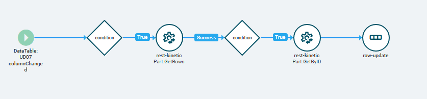

I tried working around this by adding a Part.GetRows call first, checking if anything comes back, and then calling GetByID only when a match is found. Something like this:
  1. Event: UD07 columnChanged
  2. Condition: PartNum is not empty
  3. REST: Part.GetRows
  4. Condition: {UD07.PartNum_c.length} > 0
  5. REST: Part.GetByID
  6. Row-Update: Set UD07.Description_c
However, this still doesn’t work. The GetRows doesn’t prevent the GetByID from throwing an error when the part doesn’t exist.

So the widgets in the events have a habit of running even if the prior one failed… I feel like even in alternate branches.
You may need to change all of your arrows to “SUCCESS” or whatever it is called, instead of just plain arrows. (Well, don’t change the true/false arrows or others that have a value.)

I set all connectors to “True” and “Success” which didn’t help.

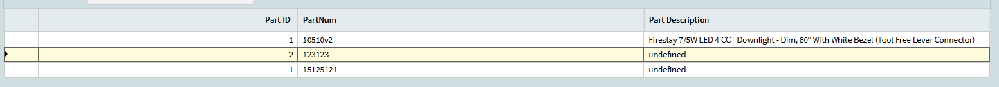

Seems now it doesn’t error, it will put ‘undefined’ in the
Description_c field, if the part is not found.
But also doesn’t fill the Description_c field if the part does exist.

Sorry to be picky, but I don’t see a label on the last arrow.
Maybe that won’t solve it, but I’d want to try…

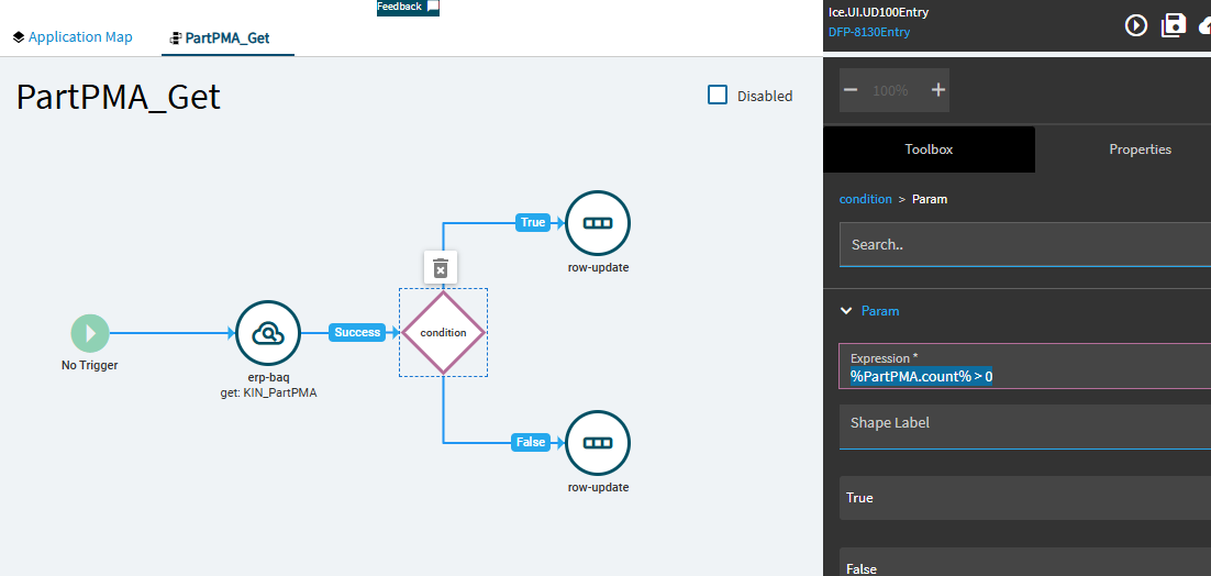

I did something similar, except with a BAQ, and my condition was this:
%PartPMA.count% > 0

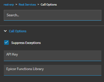

Managed to resolve this by enabling ‘Supress Execptions’ in the rest-kinetic Call Options.
Thanks all for your input.
