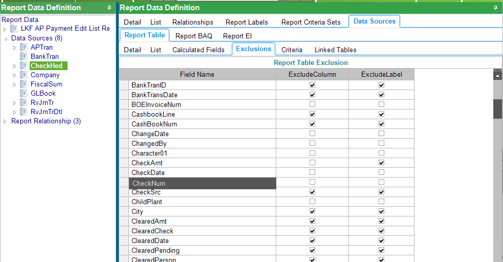

Currently we have the AP Payment Edit List that have some of the fields been checked in the exclusion list.
As user need to have the “Check Date” field and we have unchecked this field in the exclusion list of the RDD after making a copy of the base RDD.
Export of the RDD confirmed that the field is now found in this file but when we create the report style to use this RDD, however it seem that the RDL is still using the old RDL without the extra field. Did a Regenerate Data Model doesn’t help.

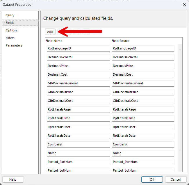

As Mark mentioned add the field into the sql query of the related dataset in the rdl, then add the field in the dataset fields section.

That is correct, if editing the RDL in report builder you would open the relevant dataset properties after adding the field to the query and then using the fields option, add in the field.
Save the follow the normal steps for uploading the RDL to Kinetic.
Got it! That’s the part I miss-out. Thanks Simon.
