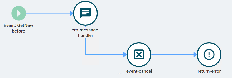

Therefore I hook my event before GetNew event.
My event is executed but it doesn’t stoping Kinetic from creating new record.

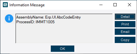

callContextClient.AssemblyName will show you what form it is from. Use a condition to check that.

Is not meant to. “Return Error” tells the other events that that specific event failed. If you were to want a message box, you would need to put an “on failure” branch on whatever called that event. If nothing else called it, nothing would happen.
It’s very rare you’ll ever have a situation where you need to block an event in the UI. The actions you’re trying to stop a user from doing are the business objects which run server side which is where BPMs come in. Disabling a user from doing something in the UI is usually done via row rules and actually disabling or making the field read only to prevent action in the first place.
The only way I can think of to block an action from the UI is to do an event before whatever native event makes the REST call, run some logic, then possibly do event-cancel? Maybe? I’m not even entirely sure that will work, honestly.
Event cancel does not stop the event you were hooked up to Before or After.

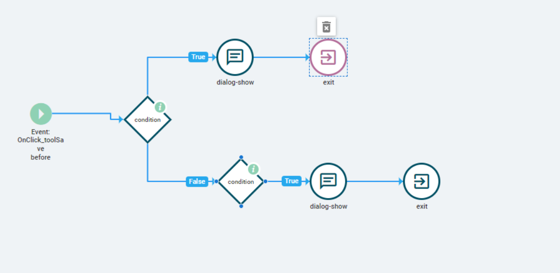

I solved it by using an Exit widget.
My use case was if someone was trying to issue material from a warehouse that cannot issue material. Very specific to our busines.
The condition checks if the warehouse equals a certain value
“{IM.ToWarehouseCode}” === “WHSEQA”
The dialog box just tells the user they cannot use that warehouse
I have one condition for the To warehouse and a similar one for the from warehouse
