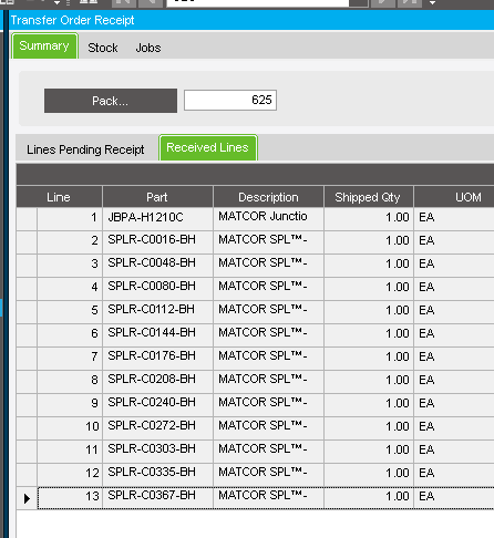

To make things worse, somehow the receipt thinks 11 of the 12 lines were received, but they never were. Only the one line created as PLT-STK transaction, the other 12 still appear to be in the orginating plants inventory.

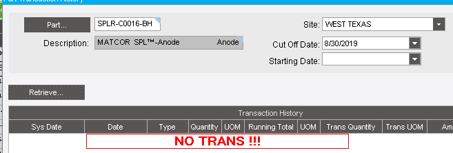

But the items I’m trying to fix never appeared in the ToPlant.

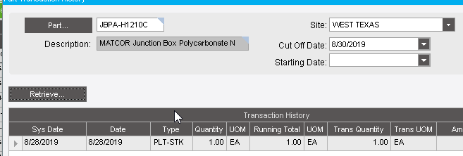

Only the first line shows any PartTranHist in the destination plant.
None of the other lines show any PartTrans

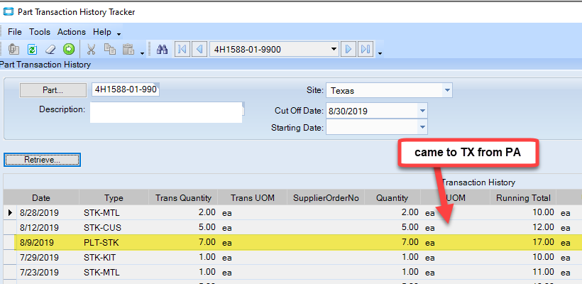

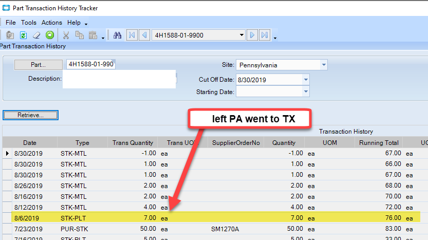

Your bottom part transaction history tracker looks fishy. It has transaction dates 8-16 with stk-plt 1 and -1 (sys date different). When we ship TO to we show positive trans qty (even though it’s reducing the running total). See below. I suspect you didn’t get any of it shipped.
It is normal to NOT show the part trans at the receiving plant until receipt done.

Yes, someone had “unshipped” the TO shipment. That’s what makes the STK-PLT tran with a negative tran qty.
What’s weird is that the TO receipt shows them being received (shows on the received lines), but no PLT-STK is created. I’m guessing it was a timing issue around the TO receipt and the TO “unshipping”.
