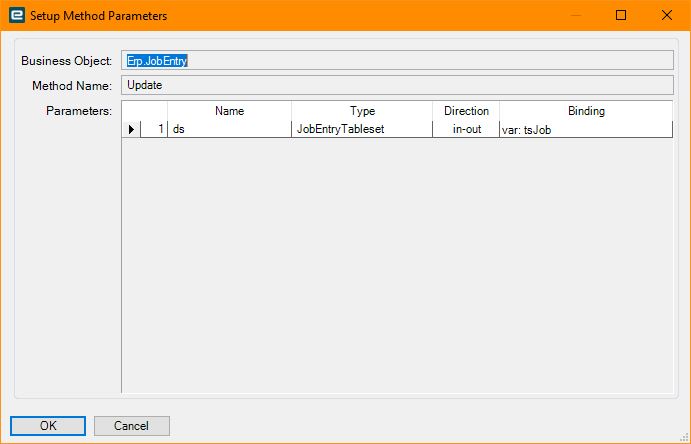

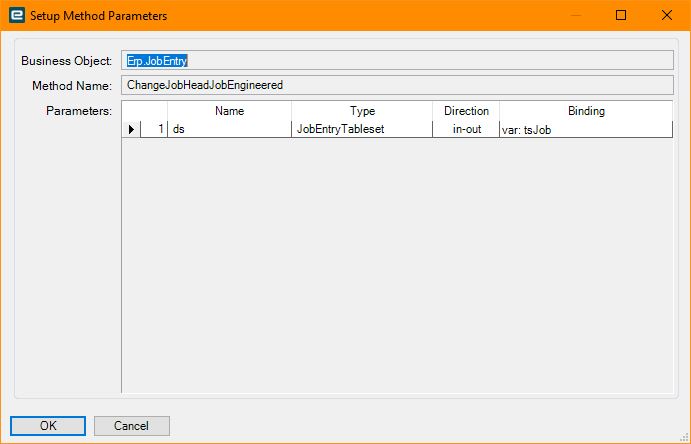

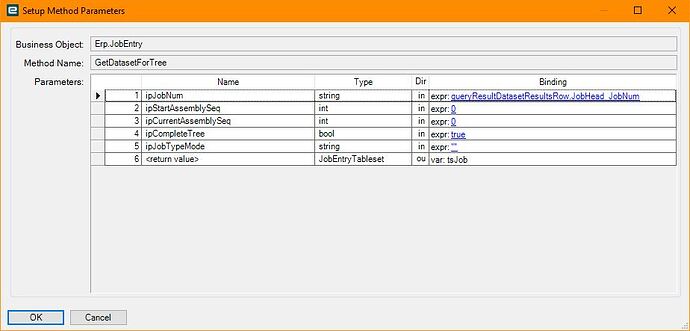

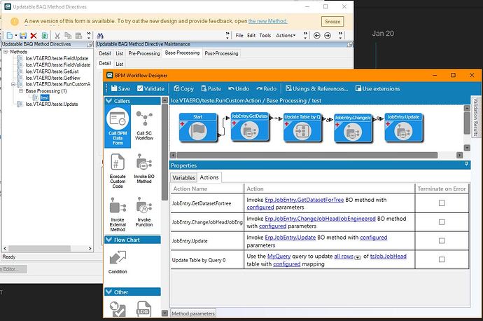

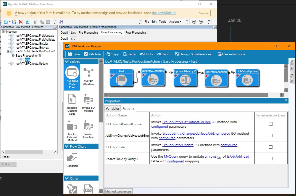

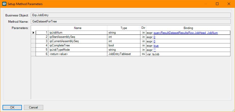

You need 4 widgets to do this in a BPM: JobEntry.GetDatasetForTree, Update Table by Query, JobEntry.ChangeJobHeadJobEngineereed, and JobEntry.Update.
The only tricky part is setting the Update Table by Query. I have attached a BAQ with the BPM in it for example.
teste.baq (48.7 KB)
I have hardcoded this for one job, so you will have to change that filter. Otherwise the BPM part is pretty simple.
Good luck!

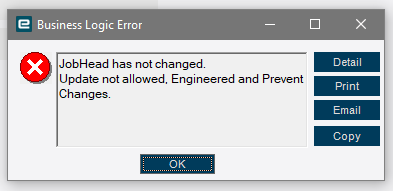

@NateS I appreciate the response. I tried to run it the way you said, but cant seem to get around this error:
Update**
I currently have been able to get passed the “JobHead not changed” error - by updating the “Rowmod” field to “U” -
Now I just cant get the Update to run -:> it produces the Job engineered , prevent changes error.

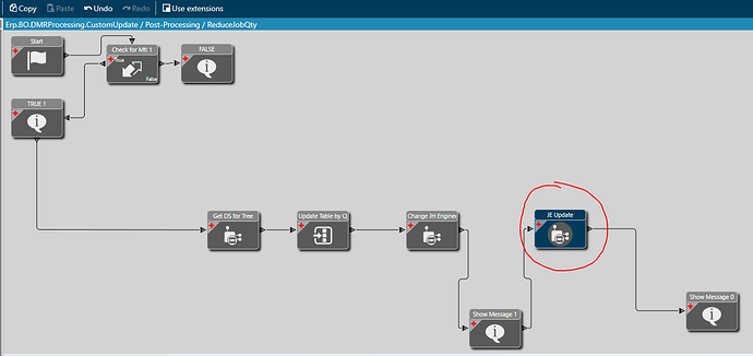

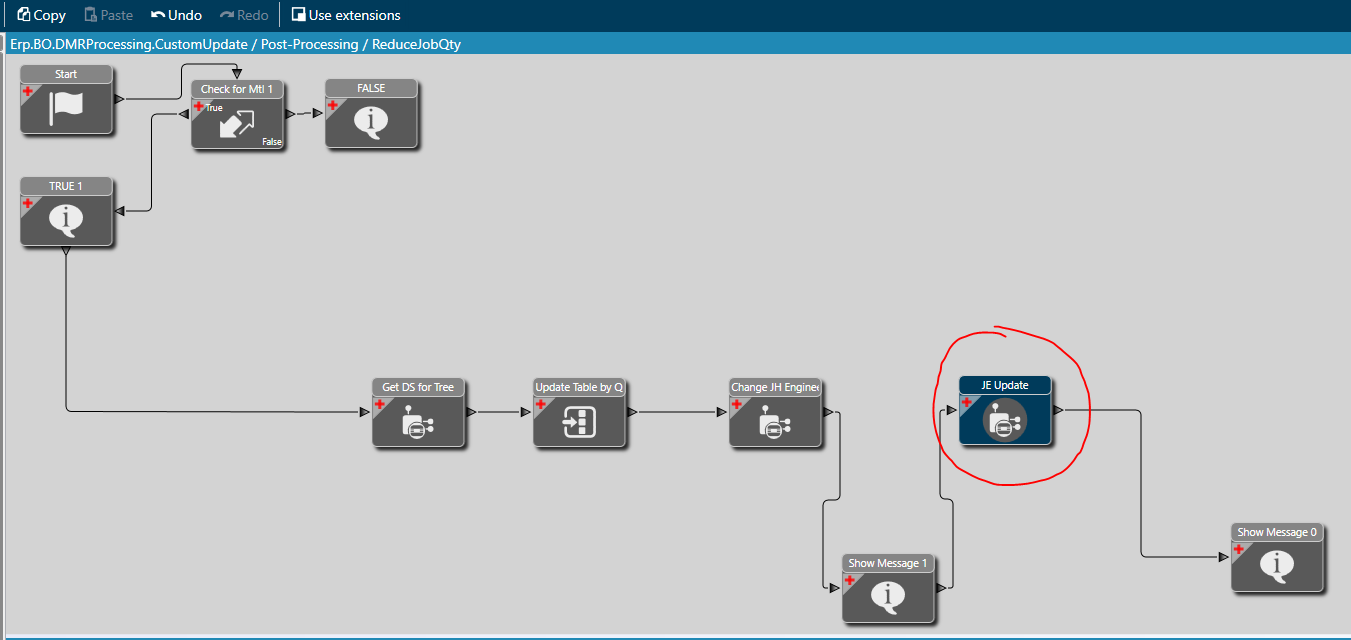

here is what my BPM flow looks like currently, any tips?
Like I said above, Update() gets angry about engineered jobs when you hand it a dataset that has anything more than just the JobHead row. You can’t just call GetByID or GetDataSetForTree, edit it, and pass it along to Update. Those will have the entire job populated (assemblies, ops, opDtls).
You have to copy header row only to a 2nd blank dataset. Then call the methods referenced in my link to properly unengineer and save the job.
This did work for my example BPM. I didn’t extract the header row as you said. Perhaps running this as a Method directive yields different results than the way I ran it. I just had a BAQ with BPM as a test.

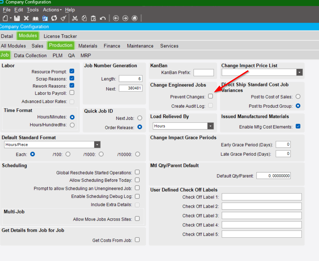

I used Update, not UpdateExt. My BAQ is posted above if you are curious. I think you are on the right track with the lock changes thing. In my Company Configuration > Modules > Production > Job > Change Engineered Jobs: The Prevent Changes flag is not checked!
Haha, yeah. That will make all the difference here.
So, what does this mean for jobs updated this way? With that flag turned off, I can use this simple BPM to unengineer and unrelease a job. Does this mean that I am breaking something in the background? I don’t use this process, but I assumed it works.
No, I don’t think you’re breaking anything in terms of the system. This is more of a policy/process thing.
If you don’t check “prevent changes” then the system is a lot more lax about editing engineered jobs. Pretty sure you can go into Job Entry and edit whatever whenever. The backend stuff is certainly unrestricted.
If Prevent Changes is checked, then JobEntry module will hard reject any changes to the job unless you go through the aforementioned steps to unengineer the job first. ScheduleEngine and JobManager modules will allow limited access to a a few fields (mostly dates and in the case of JobManager JobHead_UD fields) largely for the purposes of scheduling.
Even then, ScheduleEngine is not going to (for example) write back Resource changes in the schedule table to the JobOpDtl table when you flex to a different resource.
@jtownsend Yes, unfortunately we have to keep that checked for our company, since we are in the med device industry.
