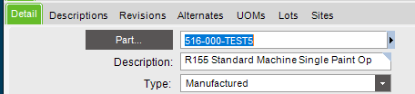

We have had issues where the part type was not set to the same value on both the main part detail and sites > detail tab

  1. Part set as purchased in part level! Check the part’s site setting, not only the main setting.
