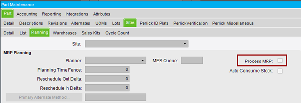

The part site planning tab needs to have the ā€œProcess MRPā€ box checked, the order release needs to be firm, and there needs to be a valid revision in order for MRP to generate a job.

I looked under the Part site planning tab in Site Maintenance and did not see a ā€œProcess MRPā€ checkbox? Where is this checkbox located?
It’s under Part > Site > Planning

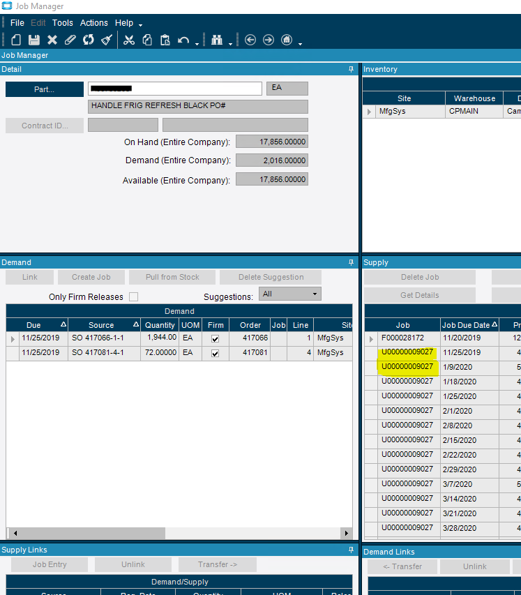

You can see unfirm jobs in your Job Manager or Time Phase.

I have verified it is checked as ā€˜Process MRP’ in Site Planning, revision is back dated and active, Part is manufactured, order is firm released and still not seeing an unfirm job created. I checked Job Manager, with no jobs. I tried setting up logging to go to the D:\ drive but I did not see the log. What should my Process MRP parameters be as far as cut off and schedule dates?
