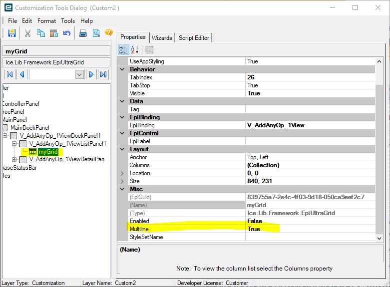

You need to create a customization for your dashboard. Turn on developer mode, then open your dashboard. Right click in the negative space of the form and click on Customization. In the customization, you want to select the grid that needs to be multi-line. Then, look in your properties for the grid. Find Multiline and set it to True. This will set all the columns in your grid to allow multiline.
To adjust the grid spacing, you may need some actual code.

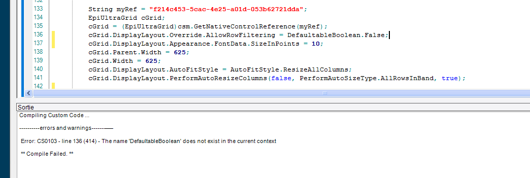

Hi Nate!
Sorry for poking you about this, but is there any “using” or anything else that we need to add for using that code, because I’m getting that compiling error:
Thanks in advance :slight_smile:
I am not sure if one of these is the right one, but here is the list I use on that form:

Found it!
I had to use those:
using Infragistics.Win;
using Infragistics.Win.UltraWinGrid;
Thanks for your quick reply sir! :slight_smile:
