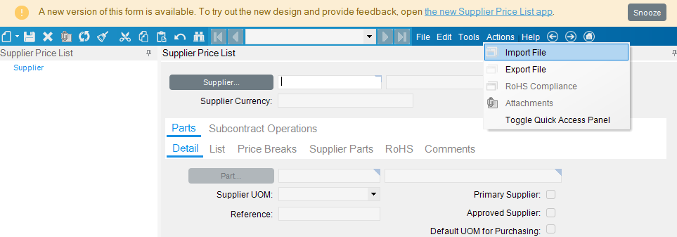

There is this:
This is one Supplier at a time if I recall.

I was thrown off by this.
To your credit, I see that if you use Export Price List, enter a file name, and click OK, it loads all the pricing. But in a different screen… :expressionless:
