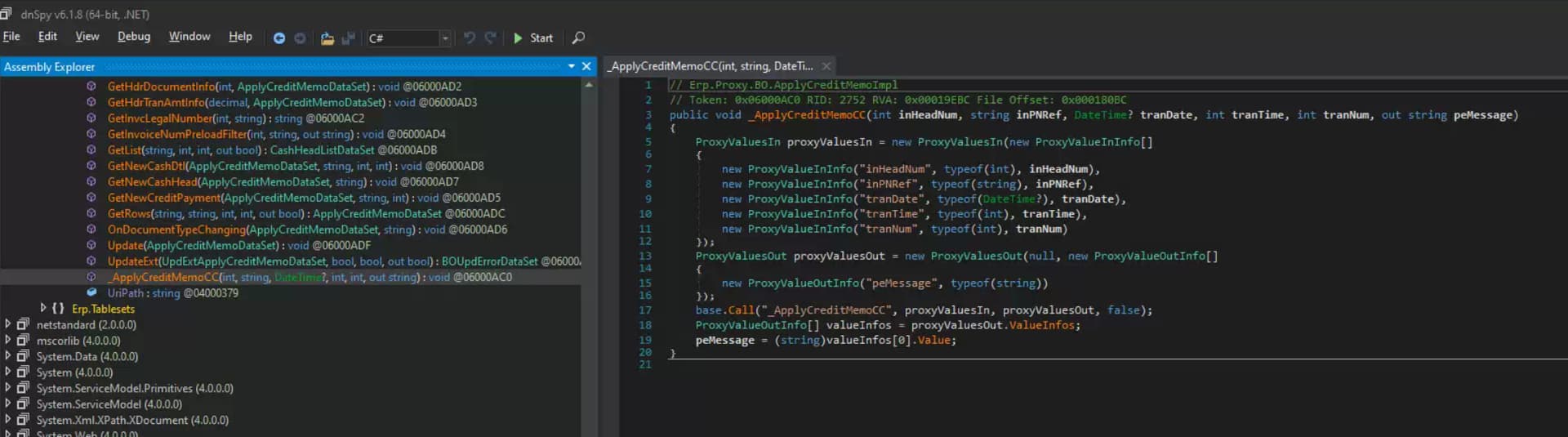

Well, I’m trying to understand what is going on in a particular BO method because I think there’s a bug. It is the ApplyCreditMemo._ApplyCreditMemoCC BO method.
So I download dnSpy, open the DLL, navigate to the method… but there’s nothing useful there?? It seems the real work of the method is happening elsewhere:
I’m a bit out of my element here, but what am I missing?
You are looking at the client side proxy. You need to look at the Service server side implementation.

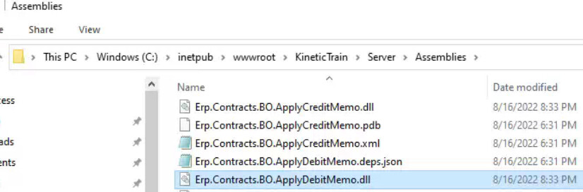

Where would that be? I opened it from server assemblies:
You need to use the service dll
Got it. Thank you!
