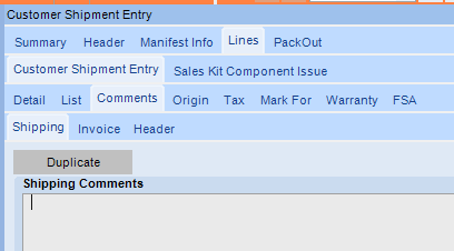

On the sales order, you have both Header and Line, Comments for Packing Slip.
The Lines - Comments - Pack, come through on the Customer Shipment Entry, Comments Shipping tab and the SO Header - Comments - Pack come through on the Customer Shipment Entry, Comments Header tab (but they will show up on the pack slip).
