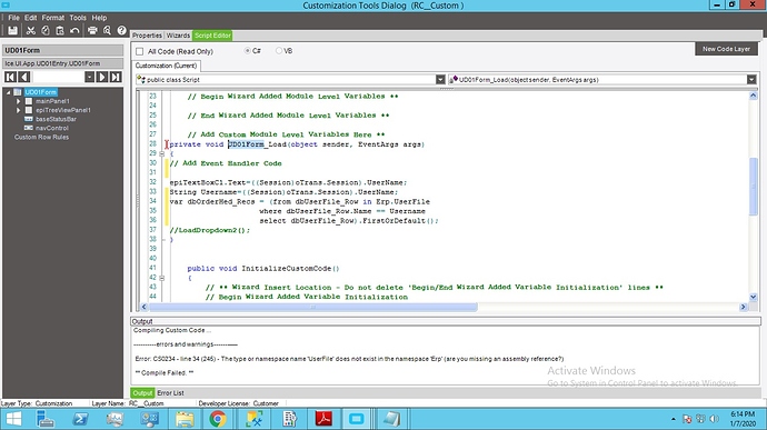

I am trying to fetch data from UserField table to UD01Form using LINQ query through c# code in script editor. but am getting " The type or namespace name ‘UserFile’ does not exist in the namespace ‘Erp’ (are you missing an assembly reference?) "Error
From what I understand, you can’t use LINQ client side. Probably the easiest way to get that would be create a BAQ and then run a dynamic query call to get the information.
You can use LINQ client side, just not in the same fashion as in a BPM because you do not have direct db context access in client side customization. @Banderson is correct you will need to query for the data as it is not directly accessible in client customization.

I already used BAQ to get the information…But am trying to retrieve through linq code.
Am new to epicor application am finding some difficulties.Can u provide any docs or any resources .so that i can work on whole linq operation.such as creating,updating,deleting data from database table through c# code in customization.Thank you advance.
What is your end goal that you’re trying to use LINQ to achieve?
In Epicor development, you really don’t want to update the database directly. Work through the business objects. https://epicweb.epicor.com has all the documentation required.
