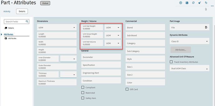

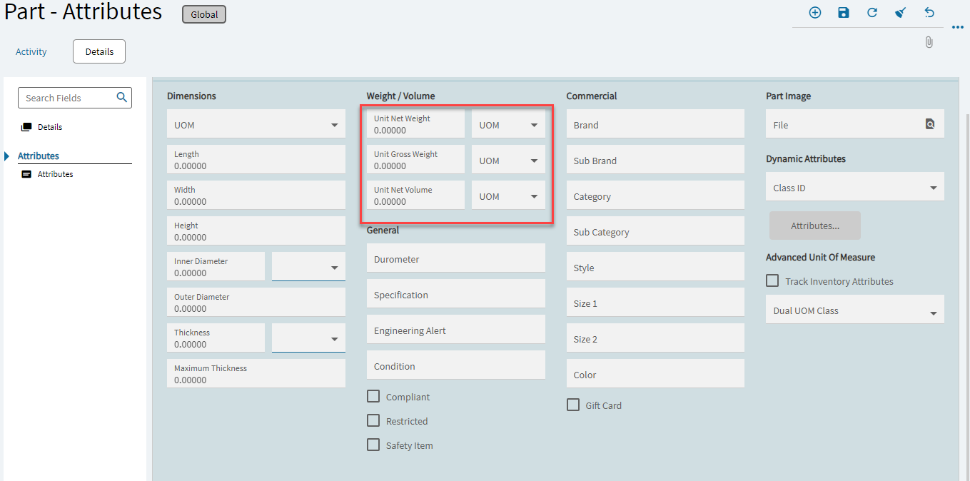

Building off of @dcamlin - check out the attributes tab on the Part.
You already have Length, Width and Height avilable.

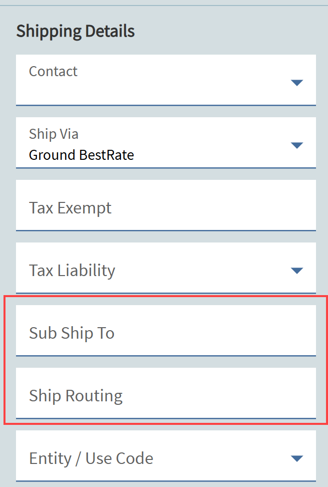

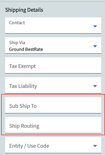

On the Sales Order Release you have some field that you could leverage

You also have weight and volume
They too can come into play when using customer shipment entry/Staging/Master Pack.
