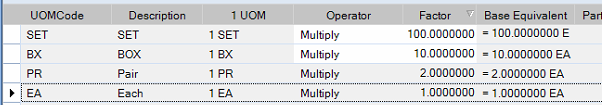

I made a part with SET and BX as UOMs.
I made a sales order for 10 sets and the job was made for 1,000 EA.
Could it be as simple as adding the “container” part to the BOM?
A job requiring 100 parts and 10 bags would obviously be for “10 BAGS” (containing 10 parts per bag)
Where as 100 parts and 1 envelope would be for “1 ENVOLPE” (containing 100 parts)
