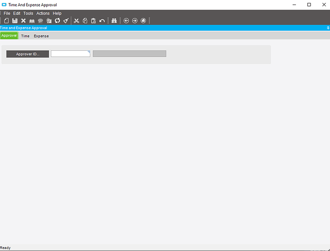

HR cannot see time and expense approval list

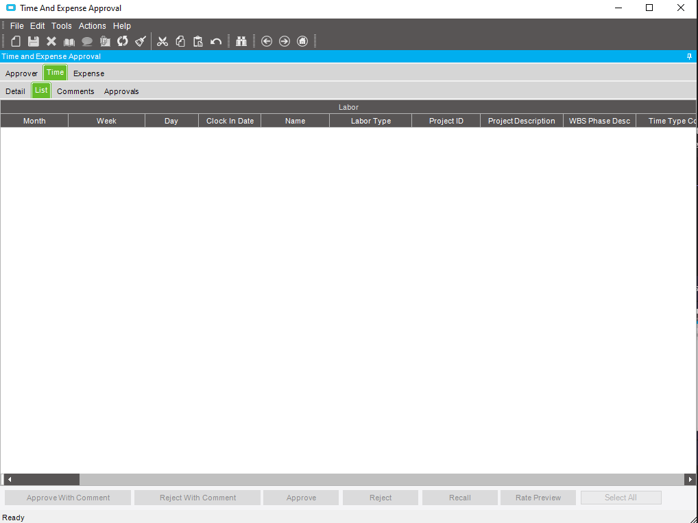

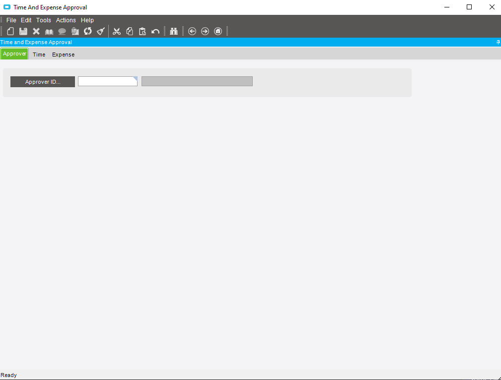

We recently switched to a new HR manager, when configuring her user within Epicor, we set her up exactly as the previous manager. However, she is unable to see time and expense list to view labor hours. I believe this is due to her not having an “Approver ID” as others who are able to see this list do have an approver ID appear and populate whenever they open time and expense approval. Where can I find to add this to her user or am I missing something completely different? Thanks!

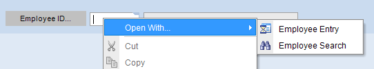

But, if the Approver ID field is like most others in the system, can you right-click on it and open-with some kind of set-up/entry menu (like the Employee Entry example below)?

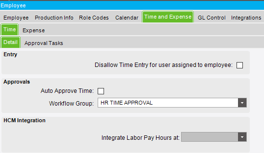

In reviewing the documentation regarding Time Approval, it appears that there can be a Workgroup possible assigned at the Site Level or more likely at the Employee to handle approvals. If so, this new HR Manager in the Workflow Group?

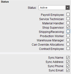

Screenshot 2024-10-10 140645
Yes, she is assigned HR Time approval for workflow group. The same as the previous HR manager.
Yes, she is listed as a shop supervisor, the same as the previous HR manager.

I believe that the Workflow Group you are showing on her Employee record is the Workflow Group who would approve her hours if required which in this case it doesn’t appear to be required. If you check the actual Workflow Group, HR TIME APPROVAL, is she listed as a Group Member.

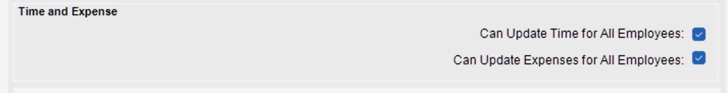

Did the previous person have these checkboxes on their User ID?
If they did, do that for the one that’s having issues.

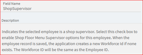

I believe when we flag Shop Supervisor field under Employee table, work force record gets created too. I thought the same that Work Force Maintenance was CRM/Sales related but it is not. It is also related with production too.
