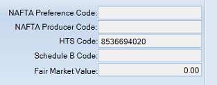

On customs document
In part master
the list

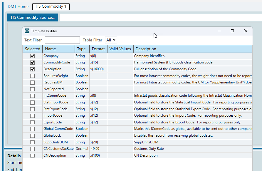

How are you uploading it? The HS Commodity screen is of course in a different format/ field names are different. I have the list you shared already.
DMT has it covered!
