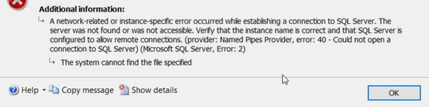

We are getting this error when logging into Kinetic 2024.1. We had some security updates done over the weekend but now the SQL server won’t connect. Working with EpicCare and it’s outside of their scope. We have also recycled app pool and rebooted servers.

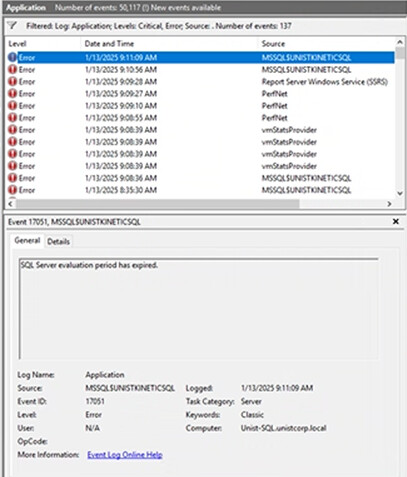

the only thing listed is about SQL server evaluation expired. which i really hope we didn’t overlook. unfortunately i cannot see the event log personally just from our 3rd party IT.
Unfortunately, it does look like our evaluation period expired as they used a trial
90 day license. Bit of an oversight. re-install of SQL server is hopefully the solution.
