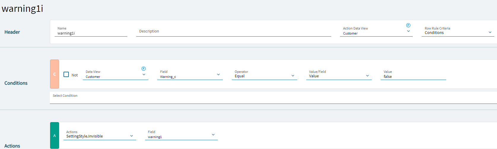

I can make field invisible with a rule but how do I make it visible in Application Studio?
OMG, I have the below rule to make a field invisible and it works great, but I cannot figure out how to make it visible. I know it must be simple but I cannot figure it out.
Please Help!
Thanks,
Richard
I’m confused. Are you NOT trying to make this field invisible?
It will remain invisible until the Rule condition is no longer met. So for your rule, row-update > Customer.Warning_c = true would make it visible.
