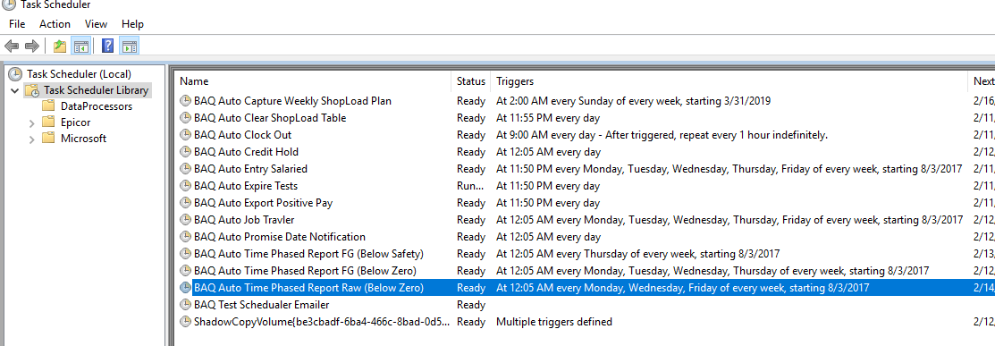

With a small app that calls BAQs via rest you can even fire stuff off from task scheduler pretty easy

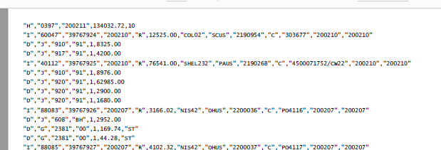

This is what I actually need, as the output format I require is more “CSV-like” than actual CSV. The structure of each row can vary. Here’s a sample:
I currently get it into the format I need in a BAQ report, but don’t know how to have the report save as a text file. Currently, we just preview the report, select all the text, copy, and then paste into a new text file.

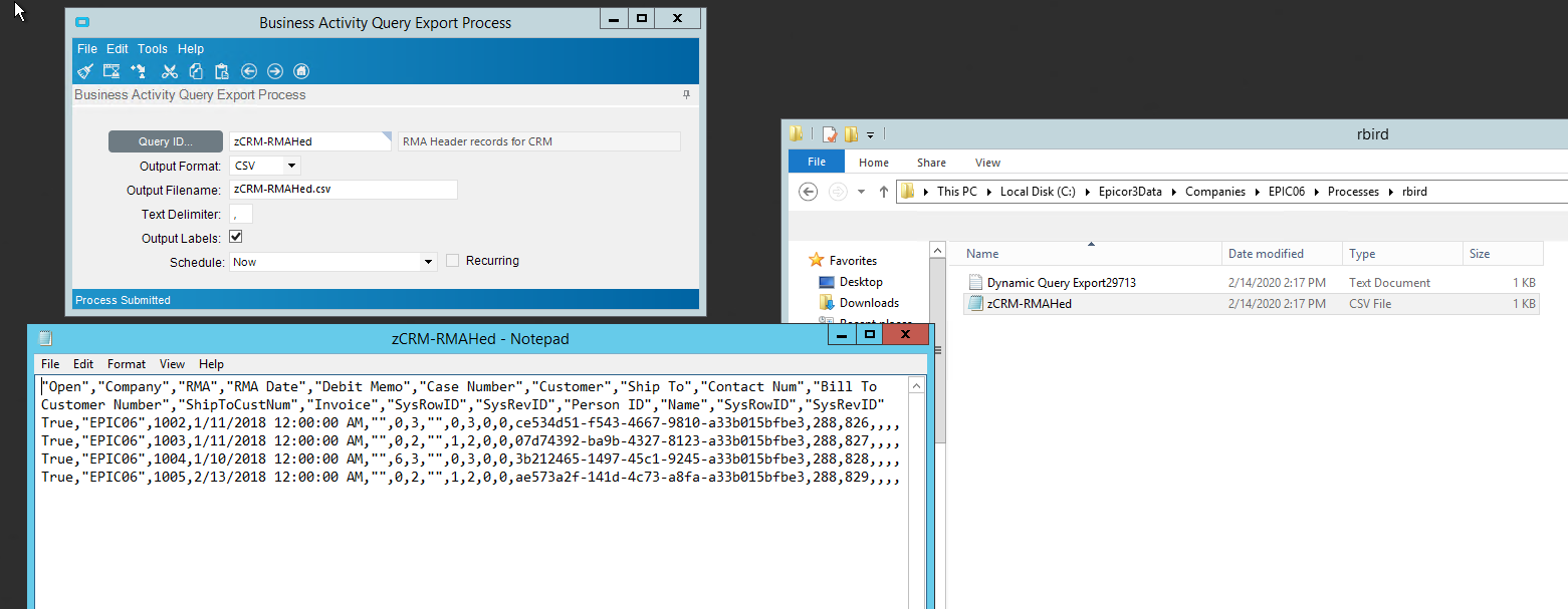

@ckrusen have you tried the BAQ Export first, it’s way easier? Usually the struggle with BAQ Export is finding the file, it’s not where the application help says it is (EpicorData), its in some odd Epicor3Data directory.
If you check the ‘Report/Task Log’ tab in the System Monitor after it runs it will give the file location.
Using BAQ Export rings a bell … I currently can’t do that as the output can have variable length rows. I currently use SSRS to do some post processing to the BAQ results. A couple of calcs, some grouping, ordering, and actual output formatting.
I need output like
"H","0397","200211",134032.72,10
"I","60047","39767924","200210","R",12525.00,"COL02","SCUS","2190954","C","303677","200210","200210"
"D","J","910","91",1,8325.00
"D","J","917","91",1,4200.00
I don’t think a CSV formatted BAQ Export could do that.
Even if I made it such that my BAQ output a single column of pre-formatted text, a value of
Because the BAQ Export converts that to:
"""H"",""0397"",""200211"",134032.72,10"
If I have individual fields (which I reall can’t have as sometimes the value in specific column is a number and other times is text)
The BAQ Export outputs as:
"H","0397","200211","134032.72","10"
