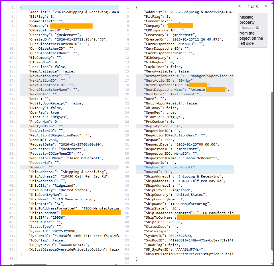

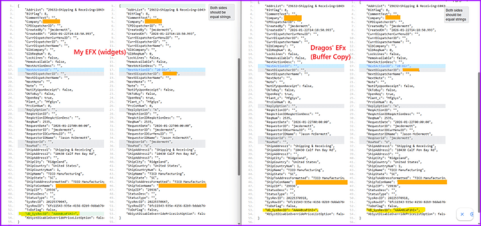

To give context, here is what I see when I compare the two rows of the trace on the Update.
Same fields as the snippet above, but I see more:
  • Adding the note (optional, OK fine)
  • Adding descriptions (likely not stored in the DB; this is probably purely a UI thing, OK fine)
  • Adding an entire new field to the second row!
To explain that, notice that BOTH have ReqUserId but only the right side (added row) has ReqUserID (with capital D; highlighted blue).
This does not correlate to others’ advice; they do not add this field; instead they just populate ReqUserId (lowercase D) on the added row. Is this irrelevant? Seems so, since others report success.

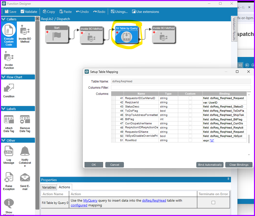

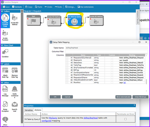

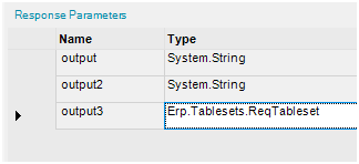

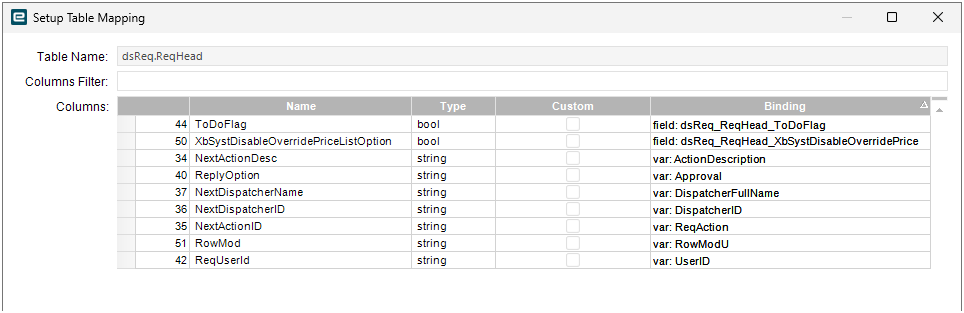

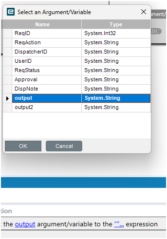

What I have done, with widgets, is:

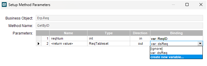

  1. Create Epicor Function with several inputs
  2. Call GetByID method (of Req BO)
  3. Use “Fill Table by Query” widget
    a. Query the existing (one) row of the dataset
    b. Map fields like the pic below
  4. Call Update method (of Req BO)

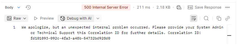

But when I test this, I get a useless error, which correlates to another useless error: Object reference not set to an instance of an object.

                        dsReq_ReqHead_StatusDesc = rowdsReq_ReqHead.StatusDesc,
                        dsReq_ReqHead_ToDoFlag = rowdsReq_ReqHead.ToDoFlag,
                        dsReq_ReqHead_ShipToAddressFormatted = rowdsReq_ReqHead.ShipToAddressFormatted,
                        dsReq_ReqHead_BitFlag = rowdsReq_ReqHead.BitFlag,
                        dsReq_ReqHead_CurrDispatcherName = rowdsReq_ReqHead.CurrDispatcherName,
                        dsReq_ReqHead_ReqActionIDReqActionDesc = rowdsReq_ReqHead.ReqActionIDReqActionDesc,
                        dsReq_ReqHead_RequestorIDName = rowdsReq_ReqHead.RequestorIDName,
                        dsReq_ReqHead_XbSystDisableOverridePriceListOption = rowdsReq_ReqHead.XbSystDisableOverridePriceListOption,
                        dsReq_ReqHead_RowMod = rowdsReq_ReqHead.RowMod,
                        dsReq_ReqHead_Plant_c = rowdsReq_ReqHead.UDField<System.String>("Plant_c"),
                        dsReq_ReqHead_SysRevID = rowdsReq_ReqHead.SysRevID,
            var queryRowsGen = lazyQueryGen.ToList();
            foreach (var queryRow in queryRowsGen)
                var addedRowGen = new Erp.Tablesets.ReqHeadRow();
                addedRowGen.Company = queryRow.dsReq_ReqHead_Company;
                addedRowGen.OpenReq = queryRow.dsReq_ReqHead_OpenReq;
                addedRowGen.ReqNum = queryRow.dsReq_ReqHead_ReqNum;
                addedRowGen.RequestorID = queryRow.dsReq_ReqHead_RequestorID;
                addedRowGen.RequestDate = queryRow.dsReq_ReqHead_RequestDate;
                addedRowGen.ShipName = queryRow.dsReq_ReqHead_ShipName;
                addedRowGen.ShipAddress1 = queryRow.dsReq_ReqHead_ShipAddress1;
                addedRowGen.ShipAddress2 = queryRow.dsReq_ReqHead_ShipAddress2;
                addedRowGen.ShipAddress3 = queryRow.dsReq_ReqHead_ShipAddress3;
                addedRowGen.ShipCity = queryRow.dsReq_ReqHead_ShipCity;
                addedRowGen.ShipState = queryRow.dsReq_ReqHead_ShipState;
                addedRowGen.ShipZIP = queryRow.dsReq_ReqHead_ShipZIP;
                addedRowGen.ShipCountry = queryRow.dsReq_ReqHead_ShipCountry;
                addedRowGen.PrcConNum = queryRow.dsReq_ReqHead_PrcConNum;
                addedRowGen.CommentText = queryRow.dsReq_ReqHead_CommentText;
                addedRowGen.ShipToConName = queryRow.dsReq_ReqHead_ShipToConName;
                addedRowGen.ShipCountryNum = queryRow.dsReq_ReqHead_ShipCountryNum;
                addedRowGen.ReqActionID = queryRow.dsReq_ReqHead_ReqActionID;
                addedRowGen.CurrDispatcherID = queryRow.dsReq_ReqHead_CurrDispatcherID;
                addedRowGen.NotifyUponReceipt = queryRow.dsReq_ReqHead_NotifyUponReceipt;
                addedRowGen.Note = queryRow.dsReq_ReqHead_Note;
                addedRowGen.StatusType = queryRow.dsReq_ReqHead_StatusType;
                addedRowGen.GlbCompany = queryRow.dsReq_ReqHead_GlbCompany;
                addedRowGen.GlbReqNum = queryRow.dsReq_ReqHead_GlbReqNum;
                addedRowGen.CPDispatcherID = queryRow.dsReq_ReqHead_CPDispatcherID;
                addedRowGen.SysRevID = queryRow.dsReq_ReqHead_SysRevID;
                addedRowGen.SysRowID = queryRow.dsReq_ReqHead_SysRowID;
                addedRowGen.CreatedBy = queryRow.dsReq_ReqHead_CreatedBy;
                addedRowGen.CreatedOn = queryRow.dsReq_ReqHead_CreatedOn;
                addedRowGen.AddrList = queryRow.dsReq_ReqHead_AddrList;
                addedRowGen.CurrDispatcherCurMenuID = queryRow.dsReq_ReqHead_CurrDispatcherCurMenuID;
                addedRowGen.LockLines = queryRow.dsReq_ReqHead_LockLines;
                addedRowGen.MemoAvailable = queryRow.dsReq_ReqHead_MemoAvailable;
                addedRowGen.NextActionDesc = queryRow.dsReq_ReqHead_NextActionID;
                addedRowGen.NextActionID = ReqAction;
                addedRowGen.NextDispatcherID = DispatcherID;
                addedRowGen.NextDispatcherName = queryRow.dsReq_ReqHead_NextDispatcherName;
                addedRowGen.NextNote = queryRow.dsReq_ReqHead_NextNote;
                addedRowGen.OkToBuy = queryRow.dsReq_ReqHead_OkToBuy;
                addedRowGen.ReplyOption = Approval;
                addedRowGen.RequestorIDCurMenuID = queryRow.dsReq_ReqHead_RequestorIDCurMenuID;
                addedRowGen.ReqUserId = UserID;
                addedRowGen.StatusDesc = queryRow.dsReq_ReqHead_StatusDesc;
                addedRowGen.ToDoFlag = queryRow.dsReq_ReqHead_ToDoFlag;
                addedRowGen.ShipToAddressFormatted = queryRow.dsReq_ReqHead_ShipToAddressFormatted;
                addedRowGen.BitFlag = queryRow.dsReq_ReqHead_BitFlag;
                addedRowGen.CurrDispatcherName = queryRow.dsReq_ReqHead_CurrDispatcherName;
                addedRowGen.ReqActionIDReqActionDesc = queryRow.dsReq_ReqHead_ReqActionIDReqActionDesc;
                addedRowGen.RequestorIDName = queryRow.dsReq_ReqHead_RequestorIDName;
                addedRowGen.XbSystDisableOverridePriceListOption = queryRow.dsReq_ReqHead_XbSystDisableOverridePriceListOption;
                addedRowGen.RowMod = A003_FillTableByQueryAction_RowMod(queryRow, addedRowGen);
                addedRowGen["Plant_c"] = queryRow.dsReq_ReqHead_Plant_c;
                dsReq.ReqHead.Add(addedRowGen);

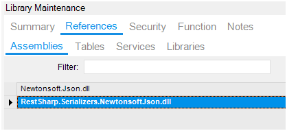

Use Newtonsoft.Json, it has a serialize/deserialze function for datasets, this is the simplest method (there are plenty of other ways too)
//references: Newtonsoft.Json
//using Newtonsoft.Json
string json = JsonConvert.SerializeObject(ds, Formatting.Indented);

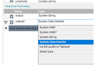

You could also simply output the dataset from the function as a variable, this will show in postman as the full dataset (it is really just serializing it to a string with newtonsoft.json the same way)
I feel like (a) you’re right and I have done that before, and (b) I have tried that lately and failed.
For both of your responses, I am using widgets and am struggling with applying your suggestions.
I added here, but that was not enough, it seems.
(I tried the first alone, then added the second on a whim.)
Hmmm, i’ve never done it in a widget function, I think i’ve maybe only written 2 or 3 widget functions, after i experienced how painful a complicated case/when statement or daisy chained if/true/false statements are, i stopped using them :smiling_face_with_tear: before I even learned what a dataset was, lol
Edit: it looks like the “Fill Table by Query” function wants to output to a well defined tableset, whereas a dataset is a dynamically designed object, im not really sure how you even get data into a dataset in widgets, lol
So the output idea. They have a generic dataset Type, but I cannot shove the real dataset into it.
If I select the real thing (I think), Erp.Tablesets.ReqHeadTableset
Then it does not show in the list of “argument/variables.”

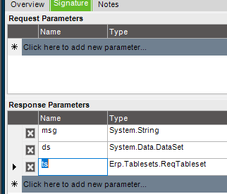

Since in this case, you are actually working with a TableSet, i think you can change your function signature to directly output that, which should give you visibility.
Then you can “Fill Table By Query” directly to that ts.
Ha, you are correct!
OK, so the norm with widgets is that you do your GetByID or whatever, then choose “create new variable” for the output.
The beauty of this is that it knows what wacky Type you need (Erp.Tablesets.ReqHeadTableset) and makes the variable in that Type.

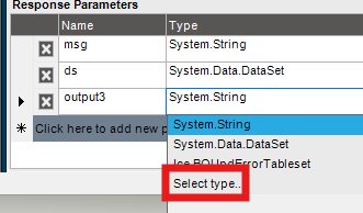

But to get the dataset into the output of the EFx, I needed to define the output (in the signature), in that type, first, and then choose it in the GetByID.
Well I see this sole difference.
So, I have a UD field (Plant_c) on ReqHead, and I think that yellow field (UD_SysRevID) is the FKV or something related.
The EFx from @Dragos has the yellow field in both rows. My EFx is missing it on row 2 of the dataset. I would guess this is causing the error.
So perhaps the insert widget cannot handle a table (View) with UD fields?
YES!!! Vindicated!
I was doing everything right; this is the issue.
So, I went into another dev DB I have (still on 2024.2, standing by for 2025.2) and blew away the UD field/table on ReqHead. Then I re-created the EFx with all widgets, and bam! It works!
So this here, “Fill Table By Query,” fails when the table has UD fields.
I’ll report it, but it makes me think that no one has done this (widget to add row to dataset with UD fields) in, what, 20 years of BPMs being around?? No way.
