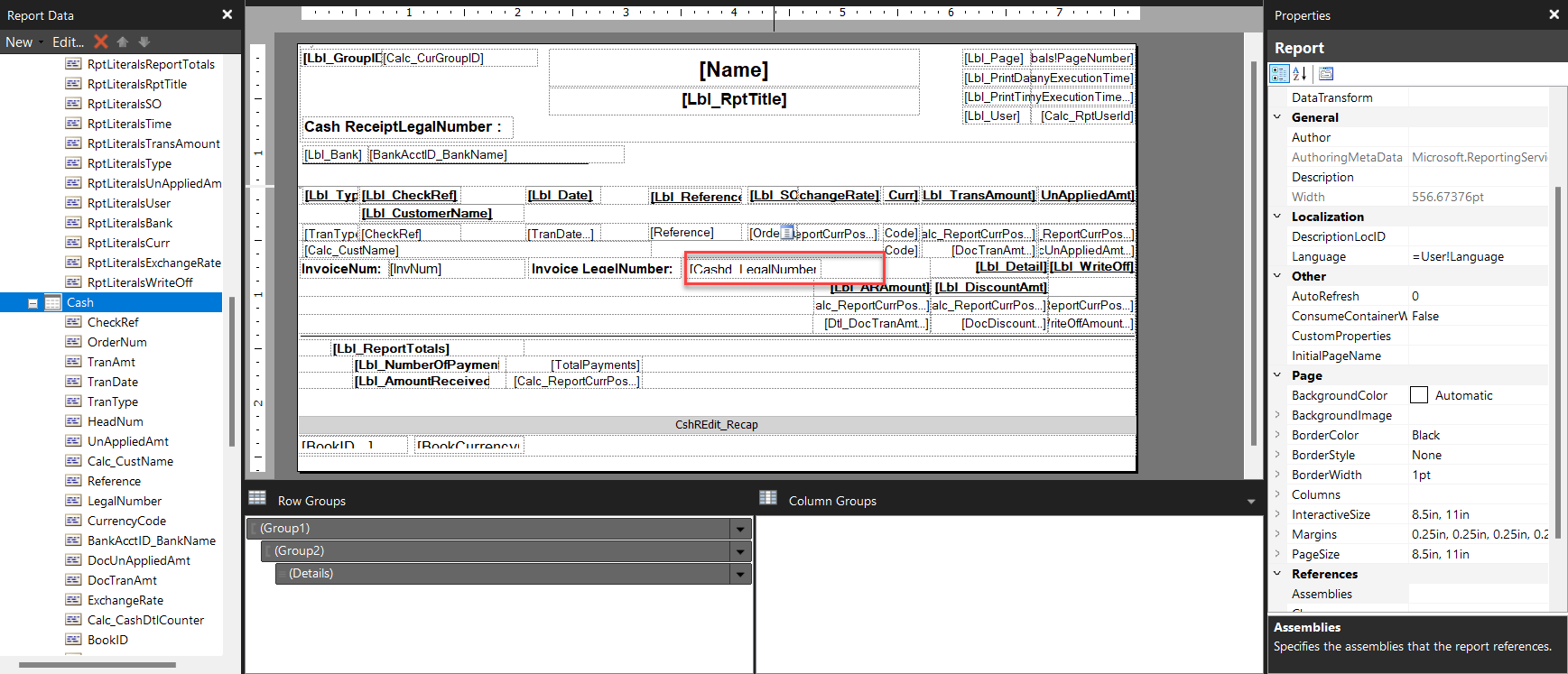

I want to add the LegalNumber of an invoice to the Cash Receipt Edit List report
I want to add the LegelNumber of an invoice to the Cash Receipt Edit List report.

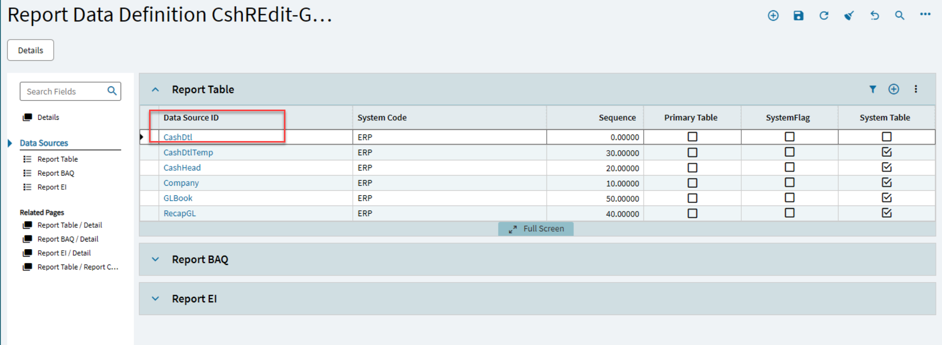

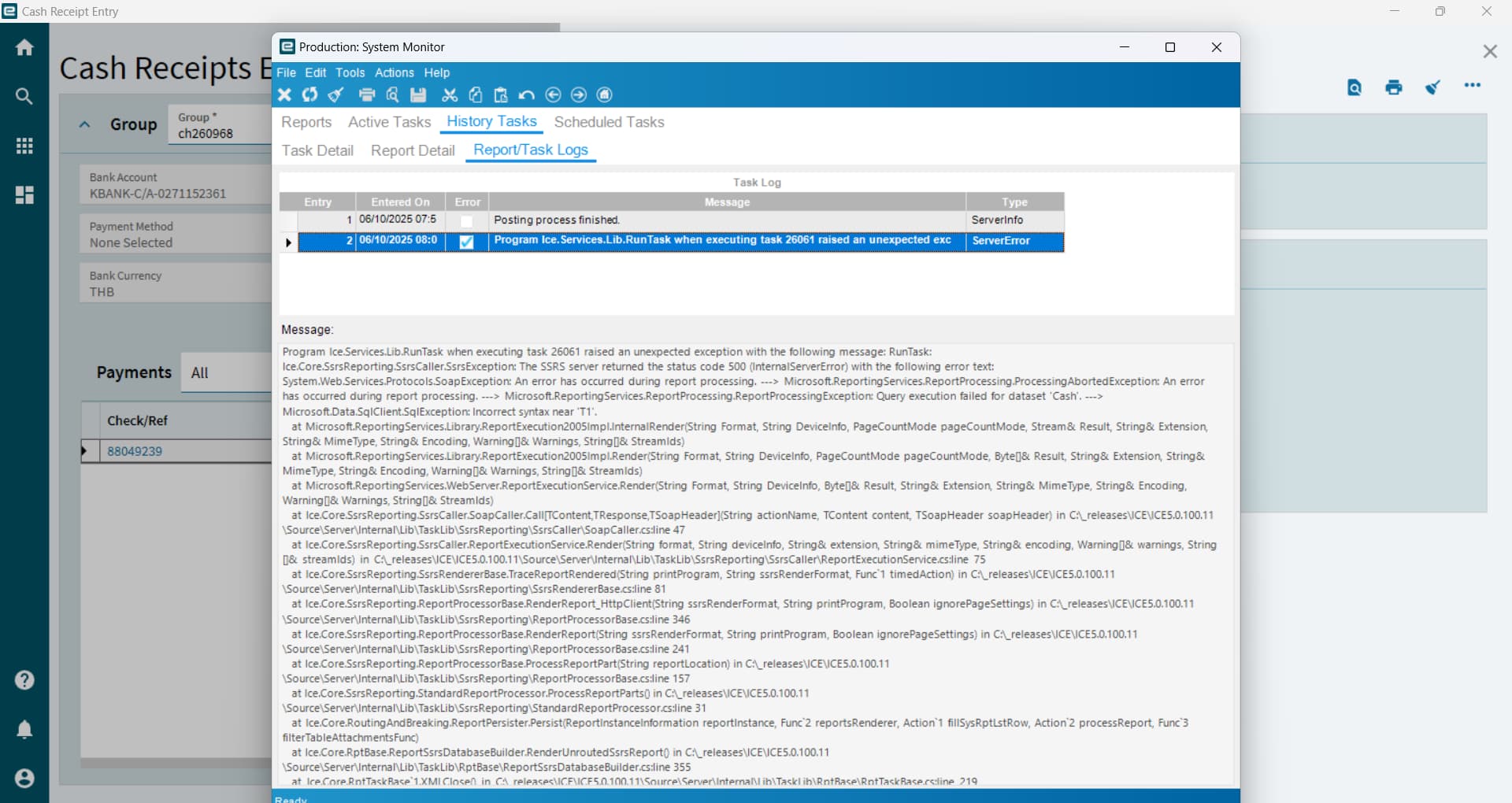

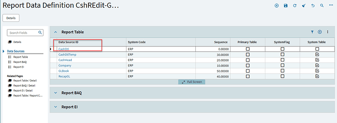

The existing system doesn’t have a CashDtl table. I’ve added and linked the table, but I can’t output the report. I’m getting the error shown in the Epicor program.
Is there a solution?

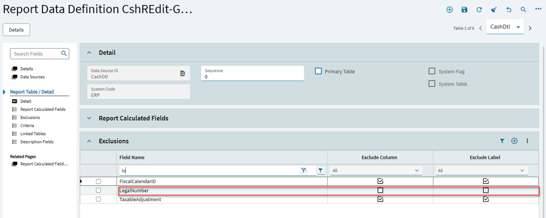

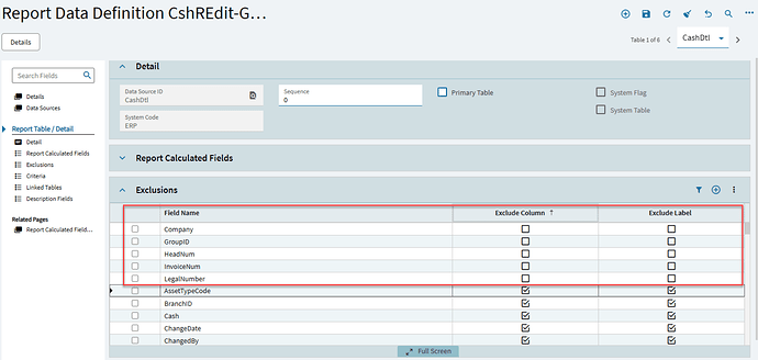

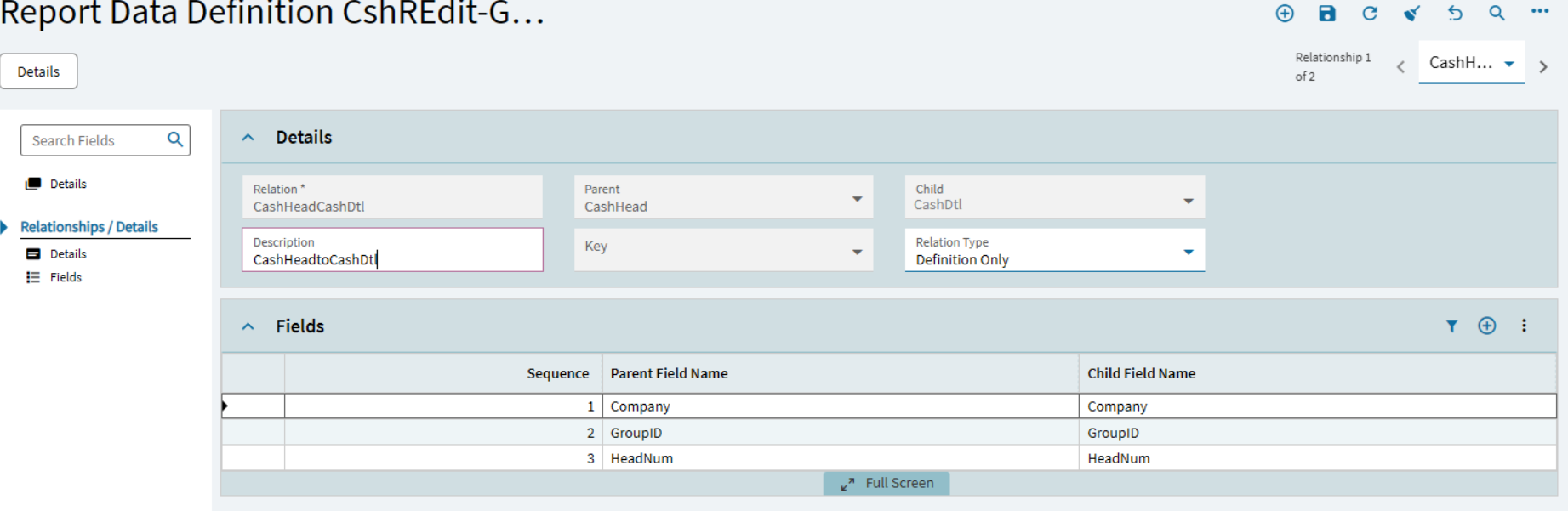

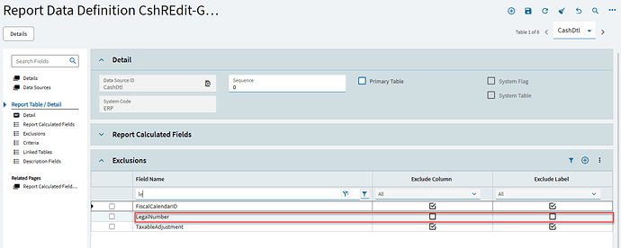

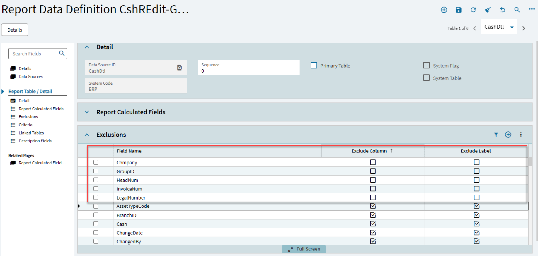

Your Third picture, did you include the columns that you are joining on? In the RDD, you need to include (uncheck in the the Exclusions grid) the fields you want AND all the fields you are using to join that table to the existing table.
I have done it but it still doesn’t work.

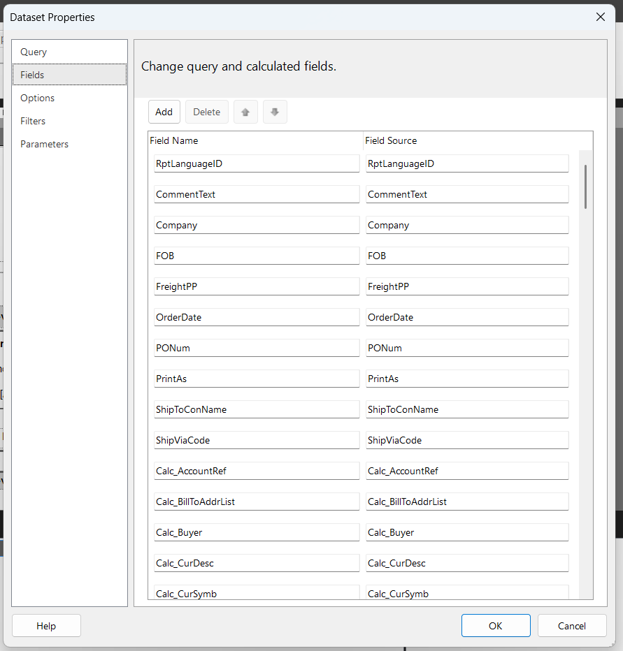

Did you add the field on the dataset in the report as well?
Yes, I added it.

I meant on the Dataset properties window > fields
Also can you send the entire error message you got? When I read the part at the beginning, "Incorrect Syntax near “T1”, it makes me think the query is wrong somehow.
Can it be because you have T1.HeadNum and T4.HeadNum? I think in SQL it’s like you’re calling 2 fields the same name. Maybe try aliasing T4.HeadNum as CashDtl_HeadNum?
