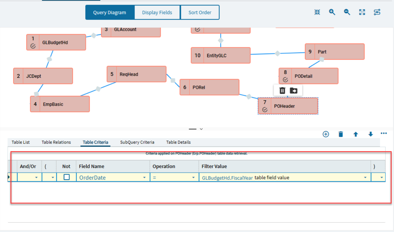

I want to compare the year of the PO opening date with GLBudgetHd FiscalYear. I did this, but no data appeared
GLBudgetHd FiscalYear. I did this, but no data appeared.
You have your criteria set to return records when the OrderDate = the FiscalYear. It’s not going to return anything. You have to compare a date = to a date or a Year = to a year.
