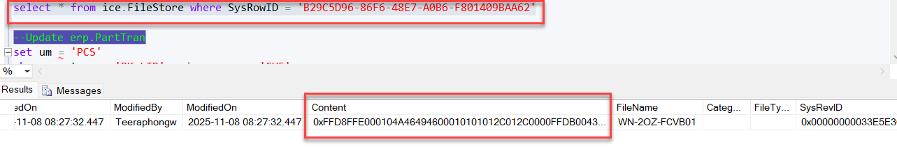

I want to display the image in the Report that is in Part.ImageID
I want to display the image in the Report that is in Part.ImageID.

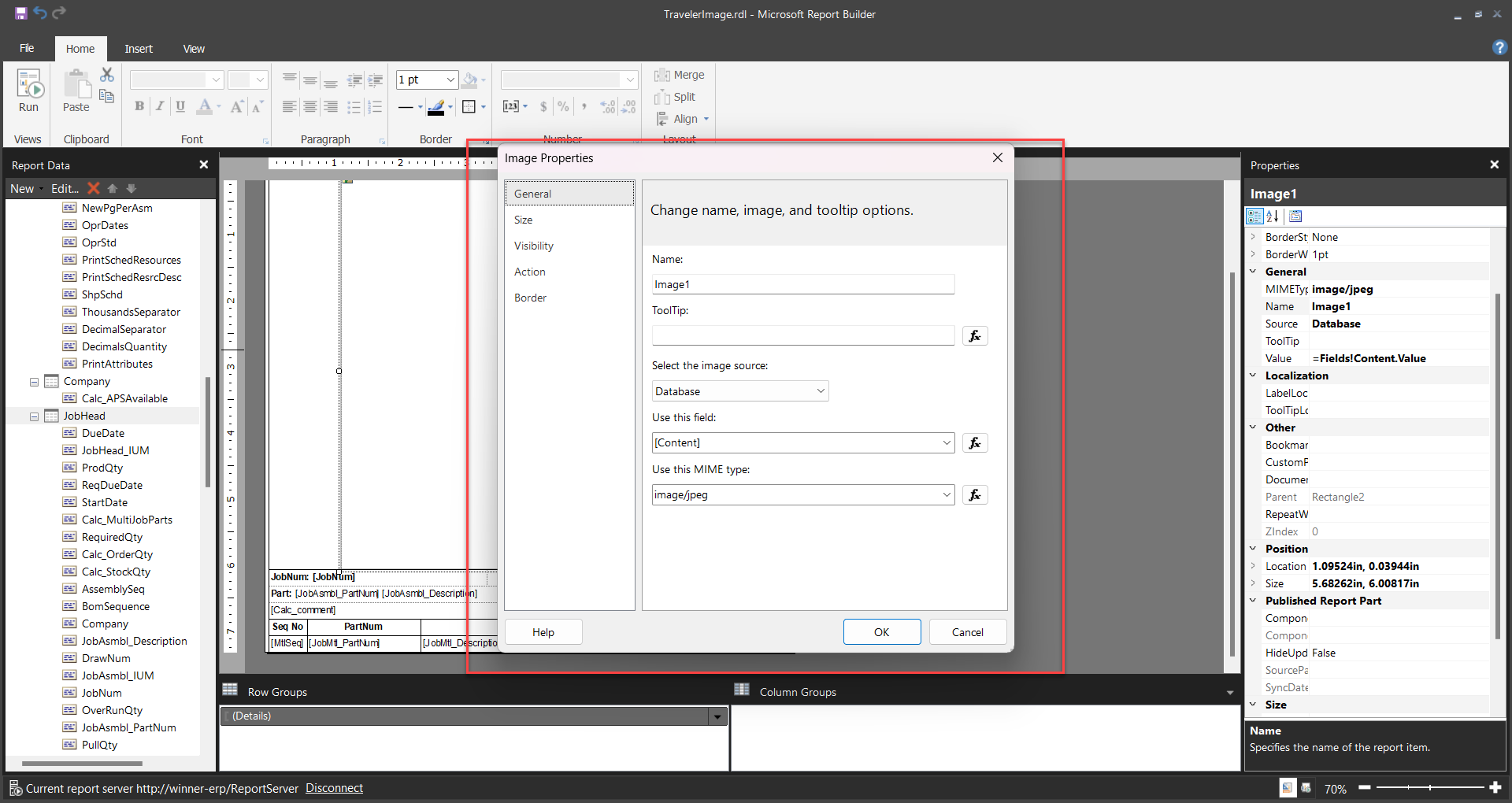

I did it but the image is not showing.
="SELECT T1.DueDate,T1.IUM JobHead_IUM,T1.ProdQty,T1.ReqDueDate,T1.StartDate,T1.Calc_MultiJobParts,T1.Calc_OrderQty,T1.Calc_StockQty, T1.SysRowID,T1.Batch_c,

Then why using [Content] field?
I’m not sure if I need to use this field.
Change your join on FileStore to Image to be on T8.Company = T9.Company AND T8.ImageFileName = T9.FileName. Then add T8.FileType to your select statement (make sure FileStore.FileName and Image.FileType are added to your RDD if not there already).
Then go to into your dataset properties and add your new query field and also add a calculated field. The expression for your calculated field will be: =Convert.ToBase64String(Fields!Content.Value)
Then add your image and in the properties:
The source will be: Database
In ‘Use this field’ chose the calculated field you just created
In MIME type add this expression: =switch(UCASE(Fields!FileType.Value)=“.JPG”,“image/jpeg”,UCASE(Fields!FileType.Value)=“.PNG”,“image/png”,UCASE(Fields!FileType.Value)=“.BMP”,“image/bmp”,UCASE(Fields!FileType.Value)=“.GIF”,“image/gif”,UCASE(Fields!FileType.Value)=“.PNG”,“image/jpng”,UCASE(Fields!FileType.Value)=“.X-PNG”,“image/x-png”)
I did it. Thank you very much.
