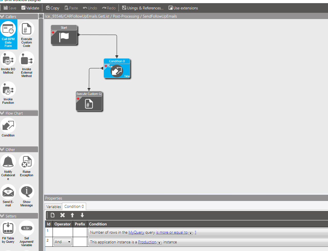

@Asz0ka, can you please send me this BPM I am trying to attach a sharepoint file with email but it’s not working for me.
Sure, it’s a UBAQ Method Directive so it can run on a schedule. Most of the email code is already posted above. Sharepoint may be the issue.
