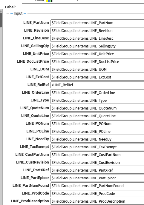

When I Submit documents from IDC to ECM using the cloned DFD, it goes into the exact same workflow as the original DFD, as desired. However, the document from the cloned DFD is getting hung up with a “Null ID in Parent” error. In the workflow audit, I can see on which step/action it’s getting hung up, but there is not enough detail to tell me what the issue is (it looks to be on a task that is populating a large Field Group for Line Details). In Epicor, I can use message boxes at different points to help me narrow down the issue, but I’m not aware of a similar troubleshooting method in ECM.
Does anyone know how I can determine which of the Field Group entries is creating the issue? I’ve pasted the error text below, as well as a screenshot of the task.

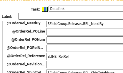

It looks like that “local” variable is defined in a datalink task in the Action immediately preceding the one referenced in the error:
Does that make any difference?
It looks like a similar thing is being done in that task for the Marketing Campaign, which is set as a default value on all items pushed to Epicor in a different step of this workflow:
The zMarketingCampaign one is typical when CRM is active in Epicor as every sales order then needs a default marketing campaign. It wouldn’t be handled quite the same way as it is a header field and not part of any line details.
The zLINE_RelRef must be being used to collect and populate references of some kind, but the issue seems to be that the order line doesn’t exist to subgroup things to. Those order lines are assigned during the PreCheck workflow step in SO Automation so I would begin looking around in that workflow step.

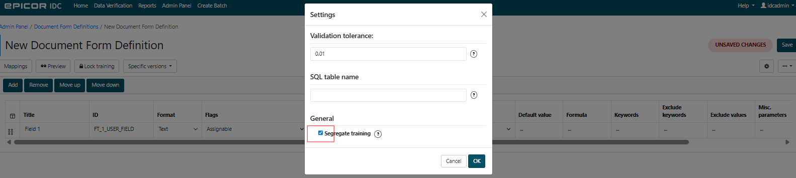

Can you show the DFDs? The training data can be shared if the Segregate training option in Document Form Definitions is unchecked.

We deliberately segregated these two DFDs. Long story short, both of these DFDs are for POs from the same customer, but for different types of orders. The POs look exactly the same when they come in, but our customer puts different information in different places on the PO for these two different order types. When we were sharing the training data, IDC was not keeping the unique mapping and formulas in each DFD separate. We segregated the training data and now the DFDs behave the way we need them to.

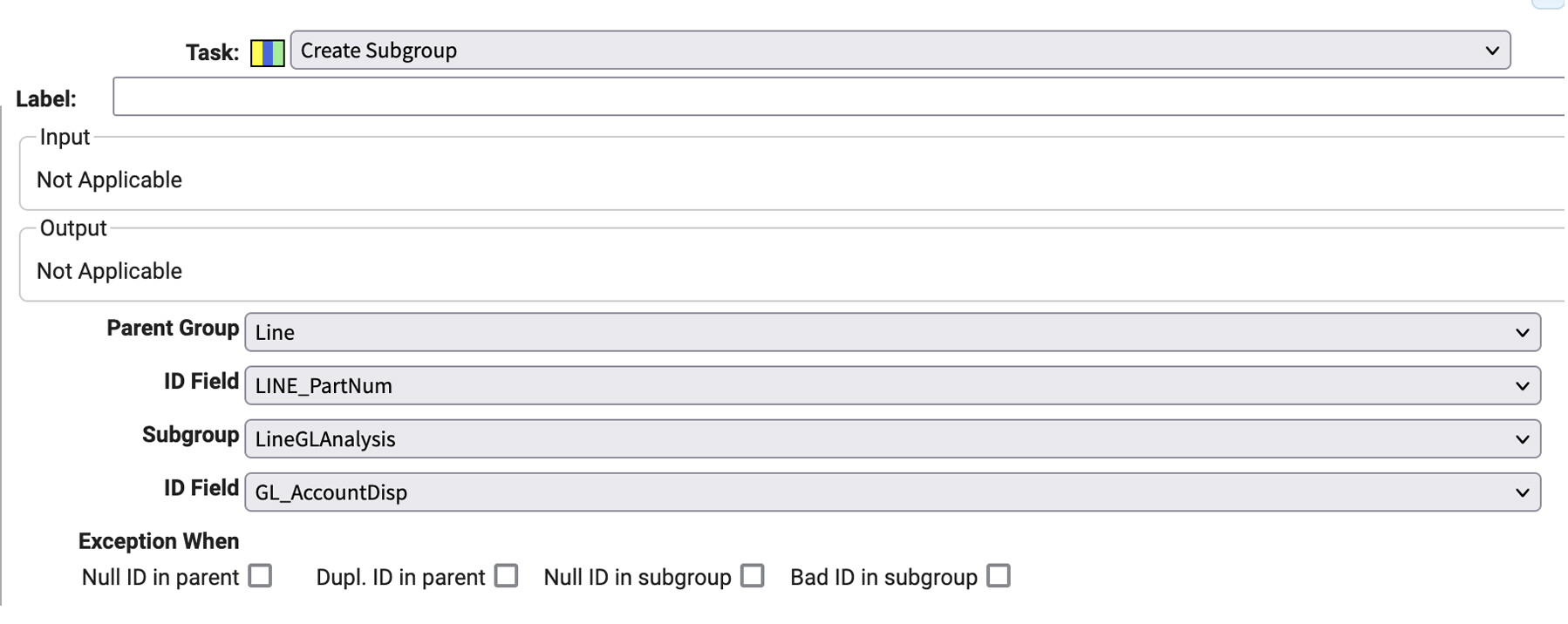

That error you had originally is likely referring to the create subgroup task where it’s throwing an error because this Null ID in parent box is checked. This is where I would start looking.
