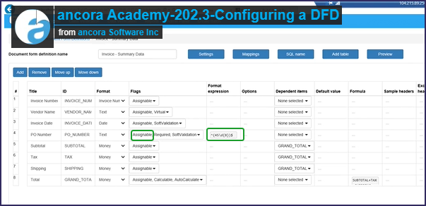

Sorry, I had read the same excerpt from the Ancora docs webpage yesterday. But I got distracted by the Format Expression video provided with that excerpt. So I forgot what I had read!
I noticed that the Format Expression video from the Ancora docs starts off with a DFD example where a Format Expression is applied to an Assignable field!
Not sure why my attempt to add a Format Expression to an Assignable field resulted in a field error (Red!) when I opened the PDF in Data Verification. I’ll play around with that some more.
