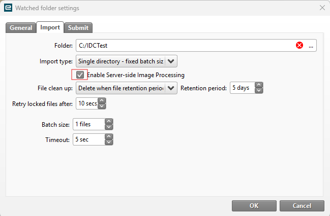

I would suggest trying the file that is directly received with no scanning involved to validate how the document processes without the scan process. Does the file work better through manual batches or is the Input Service Configuration tool used to import files into IDC? Make sure if they are Cloud to set the ‘Enable Server-side Image Processing’ to True since this has interfered with files and cause import errors.
