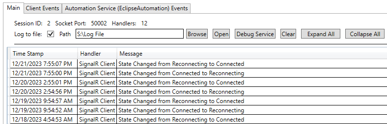

Would probably need more information to be able to provide guidance as it could be a number of things. Your best first step would be to turn on the “Log to File” option on the “Log Viewer” tab, then navigate to the “Import Job Management” tab and with the import job highlighted, select the “Send to Log” option at the bottom right. This will then create a file folder and text file in the folder listed in the “Log Viewer” tab. Within that text file will be better details as to what the cause may be.

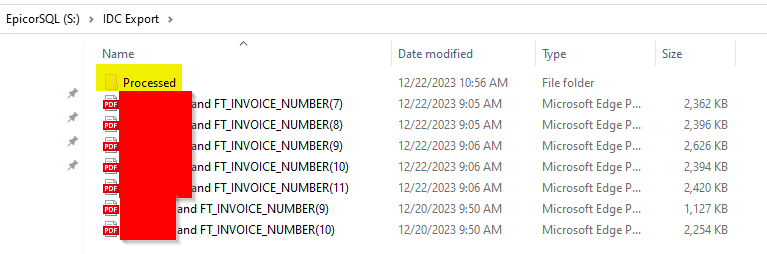

Not sure if this helps at all, but in this picture, there are 7 invoices that were processed through IDC, but never reached ECM (I had been doing the Data Verification step manually)
I’ve sent others through IDC since noticing this problem, and they would briefly show up in this “IDC Export” folder and outside of the “Processed” subfolder, but then would get moved to “Processed” soon after and I can view them in ECM.

As there as lots of potential issues that could be causing this, I am not exactly sure all that may be needed to troubleshoot this. I suppose the ECM Client batch import settings could provide some relevant information. One thing that stands out is that I don’t see any accompanying XML files to these PDF’s. Did those process and the PDF’s remain? This is assuming you are using the XML import format in the ECM Client, but that would also be confirmed with a screenshot of your setup. The Import Job Management and Log Viewer tabs could also provided relevant details.
They did have XML files that processed and left the PDF’s behind (which I meant to include in my last reply). Confirmed that the Batch Import type is XML and when I try and “Test Import”, it says it can’t find any XML files in that folder. Is it possible that the XML got processed without the PDF and so now those are trapped there?
