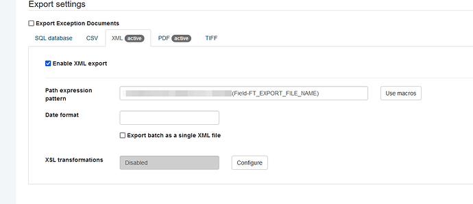

Are you using the XLST Configuration in the Batch Type? I also have a customer experiencing export issues and it is seemingly due to this. The problem seems to be that is appears to be disabled, but it is in fact enabled on Ancora’s servers. This in and of itself should just be a vidual bug, but it is apparently preventing exports for my customer while not doing the same for my colleague’s customer.

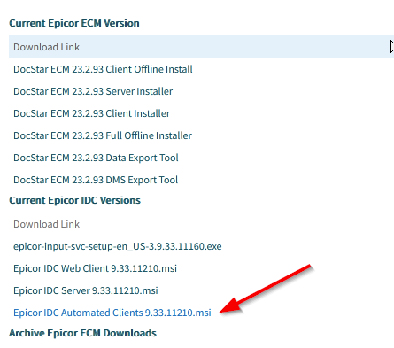

I have a ticket with Ancora Support and am working through their suggestions, first of all being to update the IDC Automated Client to the latest version (9.33.11210).

I think we need to get off of the 9.33.08230 version of the Automated Clients. The current Production version is 9.33.11210.
I can’t say that will fix the issue you are seeing with the export not working - but it may very well be the issue and the customer should have the correct version of the software.
You should be able to run the installer over top of what is already there…but do make a backup of the Automated Clients folder, grab screenshots of the Windows services (so we can see the account running the service - if not LocalSystem, the installer will likely make LocalSystem the account by default).

I am using it, and yes the indication on the checkboxes doesn’t seem to match reality, but that’s not a new issue. I tried turning the transformation off, but that didn’t have an effect. I also tried exporting CSV and that doesn’t seem to be working either.

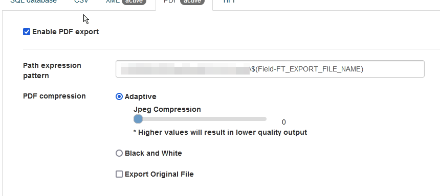

Seems to be. I would think that the PDF export wouldn’t work if that were the case. I don’t know how to see if it’s “Working”, but I’m assuming that if it’s on here that it’s connected?

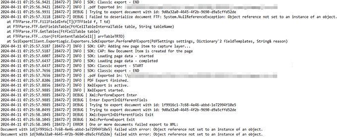

Is it all documents or just a specific one? I ask as some special characters in the output can cause issues. I am doubtful this is the cause due to the PDF exporting and not the XML, but could be worth a test. Typically, we just stick the the ($DocId) macro as it’s IDC generated and is alphanumeric with “-” in the name. This never causing issues.
All of the documents using this DFD. I have another DFD that seems to be working fine. There was a cuttoff where stuff was processing yesterday, then it just stopped, for everything.
