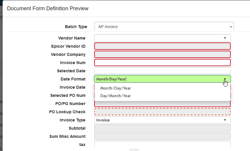

So, I set up a format option for the user to select. Then I use that option to reformat as necessary. I also cheated and sent the date to SQL to parse it for me so. SQL will take lot of different formats and parse it back to something consistent. You need some sort of SQL connection set up (we’re cloud, but they can set up a lookup DB for you). You aren’t actually looking anything up, but you can still use SQL to do some work.
This is the drop down I made. There is a “Selected date” which takes whatever is selected on the page. Then the drop down is used to determine the format. I have it set up as assignable so that it should remember by vendor which it should be. Then there is a calculated field that uses those 2 fields to give me a consistent output.
Here’s the code for the calculated field.
if ( EQ(STRICMP(MyDateFormat, "Month/Day/Year"),0),
 	PROC(
    @InvoiceDate = ARRGET(SQLEXEC(STRJOIN("Select FORMAT(TRY_CAST(' ",SelectedDate,"' AS DATE),'MM/dd/yyyy')")), 0)
	PROC(
    @DateArray =  REGEXSEARCH(SelectedDate, "(\d{1,2})\/(\d{1,2})\/(\d{2,4})"),
    @InvoiceDate = STRJOIN(ARRGET(@DateArray, 2),"/", ARRGET(@DateArray, 1),"/", ARRGET(@DateArray, 3))
Hopefully that makes sense.
