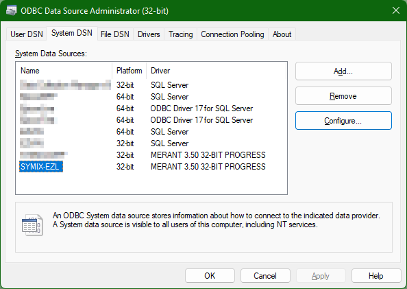

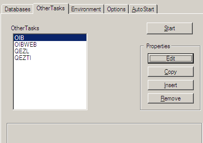

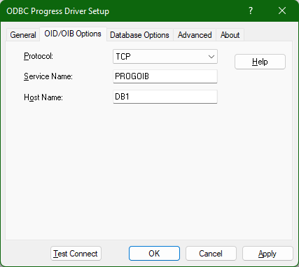

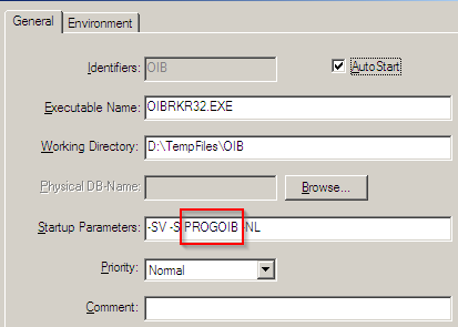

Not sure if these will help as this is for old symix progress db, but I’m pretty sure depends on the ODBC driver but this one is in the startup parameters:
