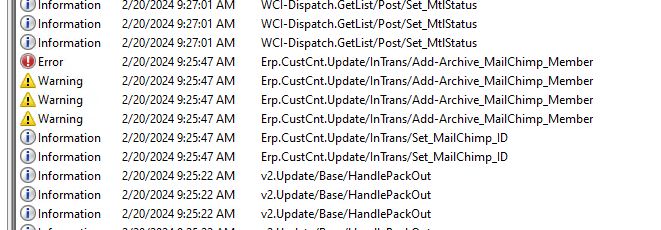

This is the result of that code in conjunction with some other logging code.
