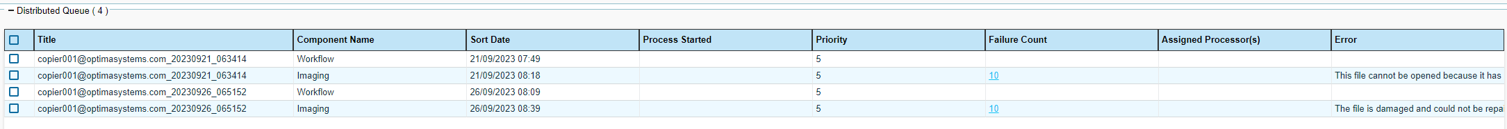

Here are a couple of examples. The error is that it can’t be processed because there are no pages but actually the PDF can’t be opened.
Here are the distributed queue entries:

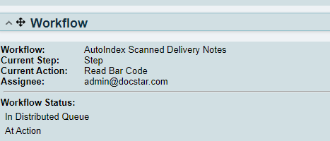

The workflow queue
Have I got a configuration setting wrong somewhere maybe? :thinking:

It’s not odd unfortunately, the EclipseAutomation service or ECM client is stuck. Use task kill to stop the service and close the ECM client. Start the service and clear the distributed queue.
I usually setup a scheduled task to restart the EAS and IDC services on the IDC server. Then the services should stay active minus any updates to the ECM client, also restart DQM service to complete this issue.
