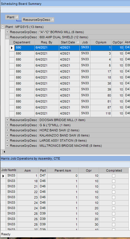

@knash Hi, Ken. I am certainly not “sure” either.
What we have in place for the Operators now is a “Scheduling” Dashboard where the query filters out all completed Jobs and Job Operations. So it essentially returns a big list of all the open Operations for all subassemblies. Yes, they can filter by a specific Job number and often do. Additionally by grouping on the assigned Resource Group the Operator can see what work is still open at a particular machine, or start to frame some ideas about what RG is the bottleneck.
What I am trying to add, is an additional query so that they can see for a specific subassembly what work is left to be completed, but to do that I need to explode through the “child subassemblies” to show them specific Operations / RGs that they should go lean on to Complete so that the “parent” can get Completed.
If there are levels of subassemblies underneath, I need to explode through all of that and return the appropriate Operations. The CTE jumped out as the solution to recursion through a structured object like Materials, Operations, or Menu items. Alternatively, I considered a customization of the Job Traveler, to include Operation status, as this report already let’s you filter by Job and Assembly - and it does show children of that Assembly by default. But, I have been working on the CTE.
Yes, it is the basic requirement, that the output takes into account the parent/child relationship. They should be able to request output for Parent level 0, or any child subassembly sequence, and get the children of just that sequence.
Had to make a decision because of the Parent Level ( 0 ) problems with the BAQ, to just Filter those out using the Query options in the Dashboard. Also added Publish / Subscribe onto Dashboard. Now the end user can put there Tracker field value in there, bring in the “scheduling board” and then clicking on any record will show the “Children” on the Dashboard,
I am toying with the idea of going back into the BAQ ( lol ) and adding in Resource Group identification into the “Children” output.
But in a nutshell, this is what I was working my way through.
I think this ended up with 2 new Epicor Support Cases, the one unresolved as yet as to why the Parent Level 0 causes grief to the CTE.

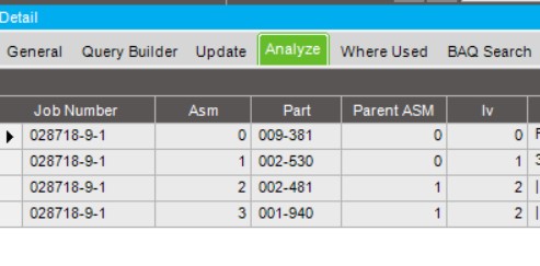

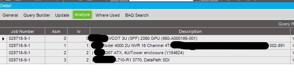

I just made a few changes to show more like the grid you just posted.
