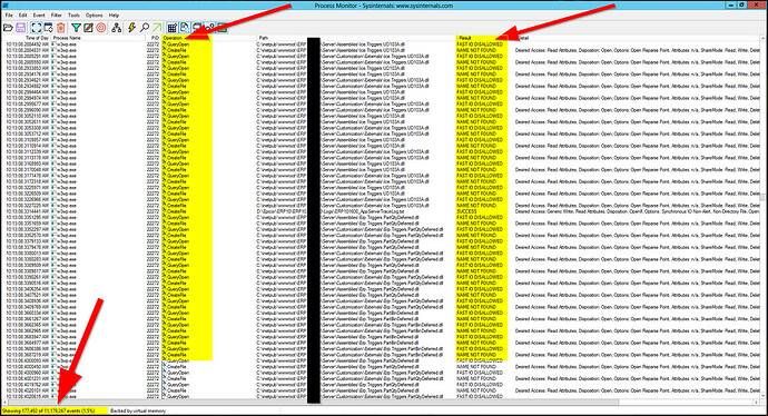

I was trying to look more in-depth at the IIS w3wp.exe worker process and I ran across some interesting activity on our Epicor w3wp.exe Process. Within the Process Monitor, I’m seeing a lot of “CreateFile - NAME NOT FOUND” and “QueryOpen - FAST IO DISALLOWED” entries (Like Hundreds of Thousands of them if I’m looking at this correctly…?) in Process Monitor. Please see image below.

When I go to C:\inetpub\wwwroot\ERP\Server\Assemblies\ folder I cannot see the, for example, Ice.Triggers.UD103A.dll file anywhere…so I do understand why it is saying “NAME NOT FOUND” but how can I figure out where this call to the Ice.Triggers.UD103A.dll file is coming from within Epicor?
We are using the UD103\UD103A tables for something we call our “Line Tracker”. Is the problem that our Line Tracker Customization is referencing the Ice.Triggers.UD103A.dll file within it (possibly through a Library or “using” statement) and possibly it doesn’t exist anymore (or was renamed with the newer version of Epicor?)

Edit: and I’m not just getting Ice.Triggers.UD103A.dll entries, I’m getting other “NAME NOT FOUND” entries as well for all of these:
C:\inetpub\wwwroot\ERP\Server\Customization\Externals\Erp.Triggers.PartQtyDeferred.dll
C:\inetpub\wwwroot\ERP\Server\Assemblies\Erp.Triggers.PartQtyDeferred.dll
C:\inetpub\wwwroot\ERP\Server\Customization\Externals\Erp.Triggers.PartBinDeferred.dll
C:\inetpub\wwwroot\ERP\Server\Assemblies\Erp.Triggers.PartBinDeferred.dll
C:\inetpub\wwwroot\ERP\Server\Customization\Externals\Ice.Triggers.ChgLog.dll
C:\inetpub\wwwroot\ERP\Server\Assemblies\Ice.Triggers.ChgLog.dll
C:\inetpub\wwwroot\ERP\Server\Customization\Externals\Ice.Triggers.UD27.dll
C:\inetpub\wwwroot\ERP\Server\Assemblies\Ice.Triggers.UD27.dll
etc…
So “triggers” DLLs are used for Data Directives
Epicor looks to see if they have a DataDirective for a particular table all the time since you could add a new DD at any point.
So that’s part of the standard epicor process I wouldn’t worry about it too much.
Basically its going Hey do I have a data directive for this table? no?.. oh okay cool!
Interesting! Ok, great! So it’s not anything that we’ve created in error or need to fix on our end. Thank you for explaining that! :slight_smile:
