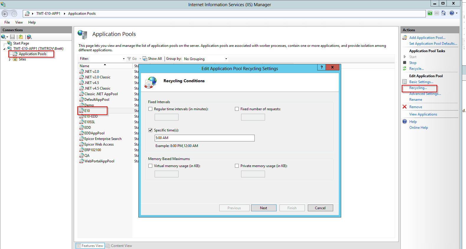

We recycle the app pool every morning at 5am. This is setup in IIS under the app pool Recycling… settings. We are on 10.2.400 now but i started this in 10.1 days when we had a memory leak in the system. For us being offline for 60 seconds at 5am is fine.

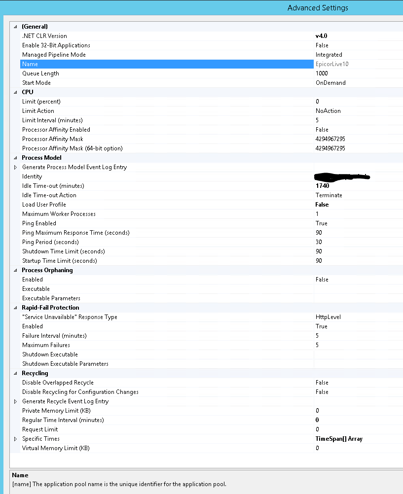

Also, am I wrong, or does Process Model > Idle Time-Out recycle the pool automatically? I inherited a system so I did not set it from scratch and it is set to 1740 minutes, or 29 hours, supposedly so it does not recycle at the same time everyday. Problem with this is that sometimes it does it during busy times. After doing some research, like @bmanners, I set the recycle time to a specific time of the day, when I know we are not processing as much. We are a 21 hours x 7 days a week shop and there is always overtime, so typically I do not have a good time to do this daily.
Someone let me know if I’m off. Even better, if someone can post a screenshot of their IIS settings, that would be great. At least once a month, I get a call overnight or very early in the morning that users are getting error messages trying to process or clock in. It’s typically that the app pool stopped and needs to be started manually. I am trying to automate the restart process, if possible.

I’m not sure I have to either. Again, I inherited the setup and am not sure it needs to recycle at all, but the Timeout was set and I noticed in the event viewer that it was recycling on it’s own and often at times we were busy, so I figured recycling at a less busy time would be best. If you are not recycling daily, what is your Idle Timeout set to?
