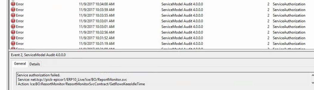

Recently upgraded from 803 to 101600, and our appserver keeps freezing/running very slow. We noticed that the ‘iis worker process’ is consuming almost 100% of the CPU. The appserver has 48gb of RAM. It gets so bad we have to restart our appserver, we are fine for a couple of hours and then we are right back to almost all of the CPU being used. We noticed this error in the event viewer. Does anyone have any suggestions as to the cause?

We ‘might’ have found out what the issue was. Turns out the PO Suggs process was hung up. We are continuing to monitor to see if it is fixed.
