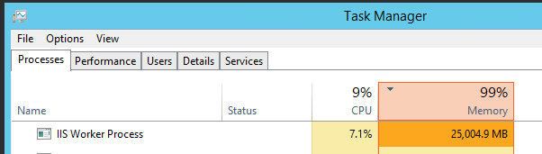

I do have this issue from time to time but not for disk space.
Usually, it only devours my ram
Only fix is a good ol recycle.
