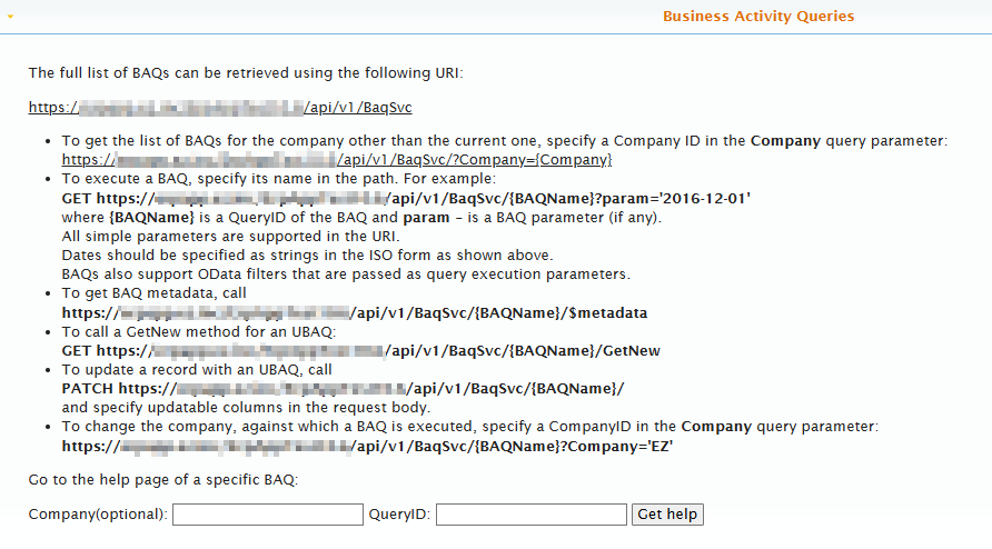

Epicor REST API v.1 Help Page:
https://server/instance/api/help/v1/
Yep
Swagger
Epicor Swagger → https://serverpath/api/help/v2/
Epicor Rest Help → https://serverpath/apps/resthelp
Two flavors of basically the same thing.

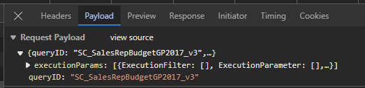

Let’s take a look at the request to run the baq.

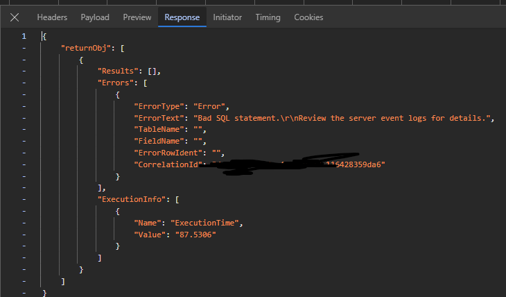

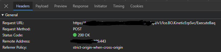

here is everything in the network tab when attempting to refresh the data grid view thingy
I do see it is using v1 not v2, could that matter?

I had given up on the conversion a while ago, what I have done now to try and figure this out, is go back to the BAQ, added some new where clauses to limit the data returned (this was done in the browser in the new BAQ builder) to less than the BAQ test limit, so I know that I am seeing all rows and it’s not a strange thing like you suggested and on Row 12069 there is a rogue null where there shouldn’t be that breaks it.
Then I went into Application studio and did just that, added a grid and wired it to the BAQ, I did this via the wizard and manually and it does the same thing either way, the new app studio dashboard will not run the BAQ but every other method of doing it works just fine.
This is leaning more towards a bug to me now, rather than something I am doing wrong.
