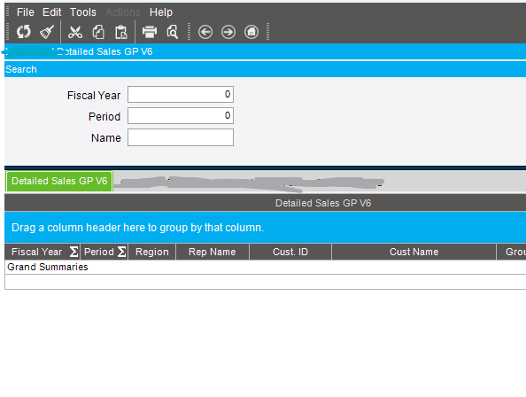

This is what the classic one looks like
Super simple, you open the dashboard, enter the desired values and click refresh.
I cannot figure out how to recreate this in application studio. The wizards cannot do it, you cannot export a version that even remotely works from the classic dashboard developer screen. and I cannot work out how to create this very simple functionality by trying to do this manually.

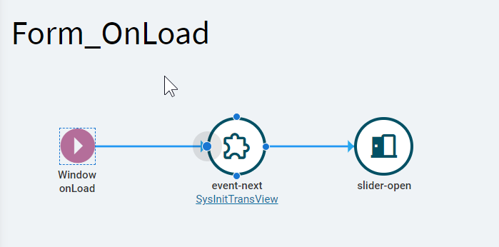

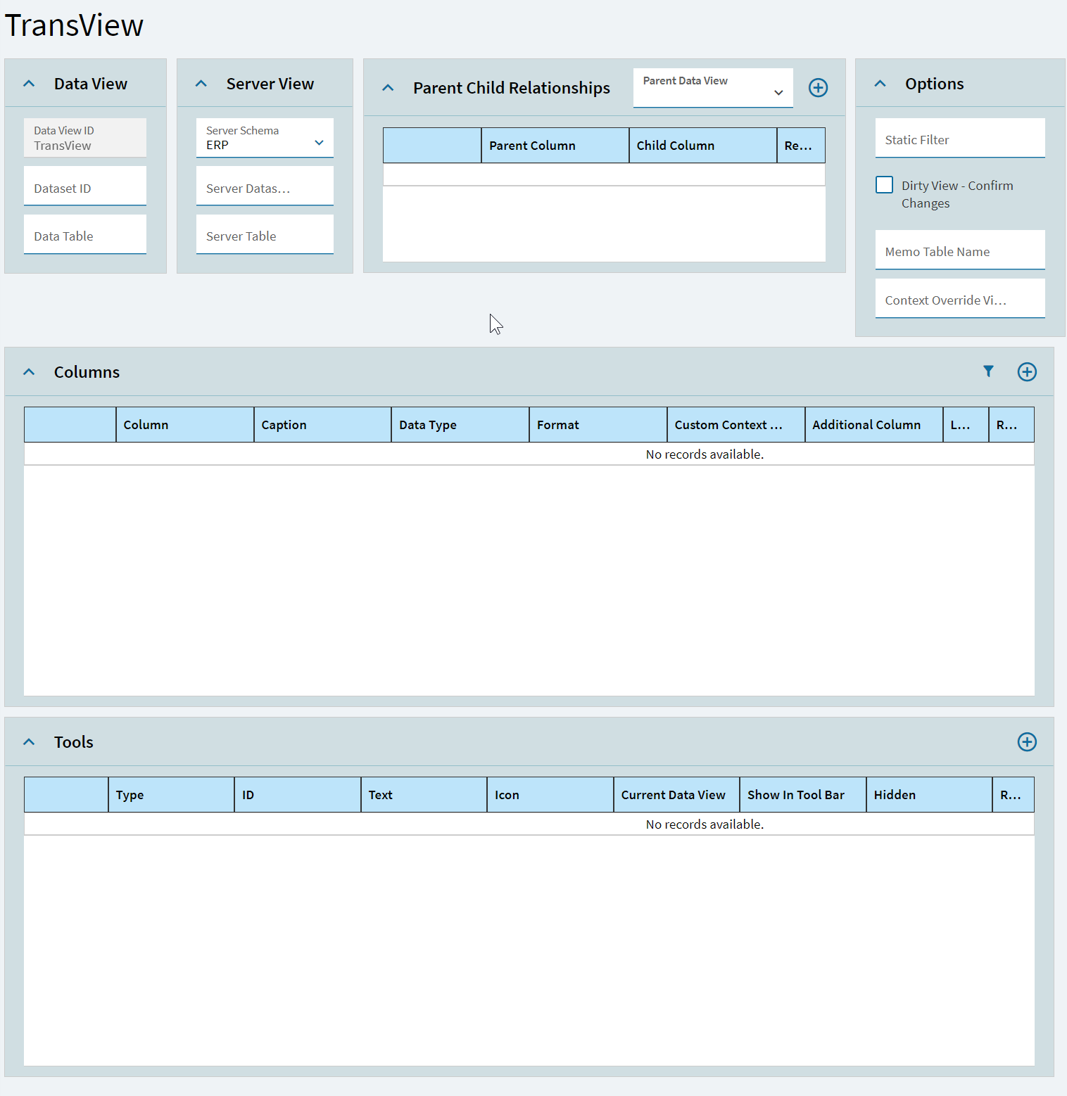

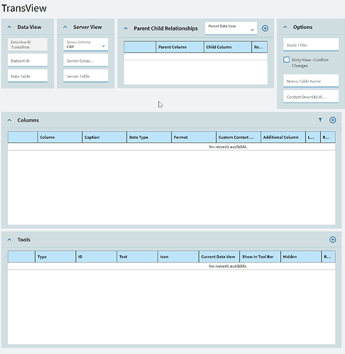

Ok, so quick process -
create the 'TransView" data view
Create data views for your BAQs BAQ/BAQ ID

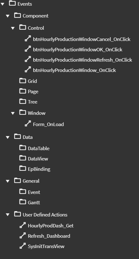

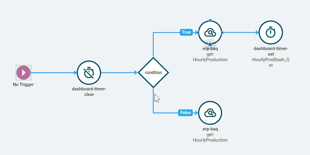

You are going to need several events:

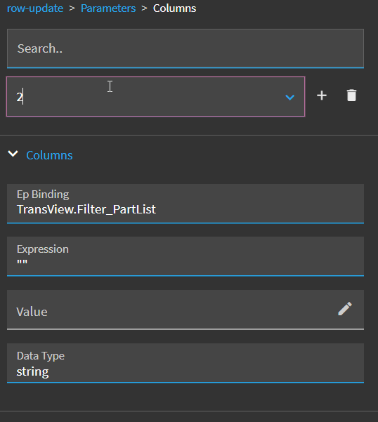

The code in the following is formatted as JSON and needs to be adjusted instead of "\"\" you’ll use "" in the column parameter field.
          "type": "row-update",
          "param": [
              "columns": [
                  "epBinding": "TransView.SysDashboardFilters",
                  "value": "%dashboardFilters%",
                  "dataType": "bool"
                  "epBinding": "TransView.Filter_PartList",
                  "dataType": "string",
                  "expression": "\"\""
                  "epBinding": "TransView.Filter_WorkShift",
                  "expression": "\"[All]\""
                  "epBinding": "TransView.Filter_StartDate",
                  "expression": "new Date().getHours() < 4 ? new Date(Date.now() - 24 * 60 * 60 * 1000).toISOString().split('T')[0] : new Date().toISOString().split('T')[0]",
                  "epBinding": "TransView.Filter_EndDate",

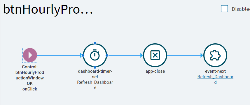

Assuming you are using optional parameters for your BAQ:
Your other events are going to be simple: slider open, slider close, refresh_dashboard
Yes I know it’s not much of a step-by-step; It’s almost five =)

As an FYI, the condition is a workaround for an issue with PartList being = “”
