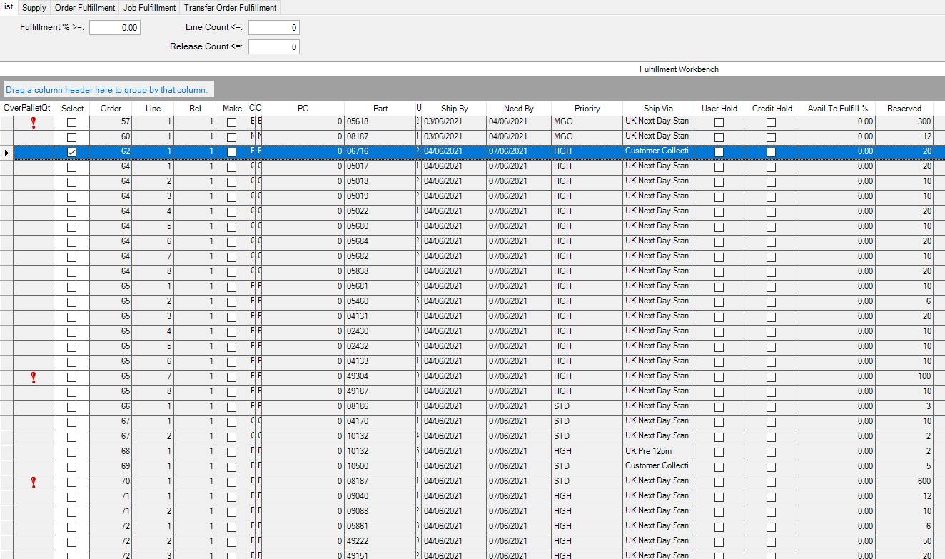

I am trying to build an Image Column Rule where the Reserved Qty is greater than or equal to a field on the Part Record.
I have the below code which kind of works but when you click on a specific line in the fulfilment Workbench it shows the Image Rule for all that match the Image Rule as per the below Image.
I just need it to show per Line and i am unsure on what i have missed from the code.
