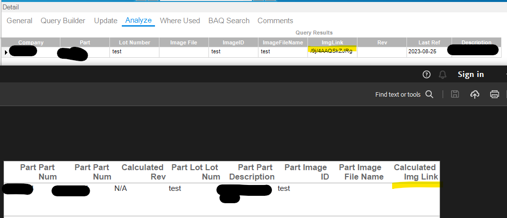

No broken image icon, just a blank image, i’ve confirmed the MIME type matches the uploaded image, and that the raw image data shows up in the BAQ
So it seems like the advanced BPM directive i have can pull the data within BAQ designer, however it doesn’t seem like it’s being pulled into the report.

It’s being returned as bytes in a calculated column, i’ve set the image properties as database and MIME type accordingly
Why is the ImgLink field filled in above? What is the field name of the bytes?
And do you have access to Erp.FileStore in your BAQ?
ImgLink is a calculated field, there is an advance BPM in this BAQ that fills in this field from the Ice.FileStore table as that table isn’t accessible within the BAQ designer

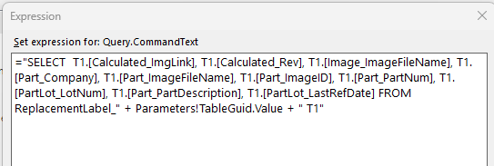

What would I be looking for exactly? This is the query, but I’m not sure what needs to be changed with this.
Things like does the field definition match the SQL name or is there a misspelling. Is ReplacementLabel_ the name of the table that the image is in? Stuff like that.

Names seem to be correct, nothing shows up when i put it as a text field
I’ve tried setting multiple properties but nothing seems to show.
Since it’s a cloud environment, would it somehow be a permissions related issue?
Unless we are doing something non-standard, like trying to reach back to an on-prem database, I can’t see permissions being an issue. Usually, the BAQ runs, all the data goes into the SSRS report tables, the SSRS queries those tables with the GUID on them, and it reports. As long as the data is in the table, it should be accessible from the SSRS report.
Would that be also the case if there is a BPM update directive on the BAQ? My feeling is that the BAQ designer is running the BPM, however when it’s run from the report itself, this BPM does not get triggered for some reason.
