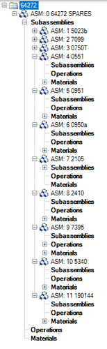

Here is an example of one of the jobs that was shipped this year that should have been a sales kit. Taking people through the mental exercise of trying to clean up the existing seems insurmountable for a company that is coming up on its hundredth anniversary. The below is why I am thinking of just forcing people to start over in a clean system.

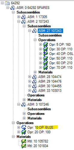

Here is another example. The important things to note are Asm 27 which is selected in blue does not have a MOM. What you see was added manually or from an old Job (which more than likely was wrong). Also, Asm 27 is a circular reference to its parent Asm 2. Also, the Op highlighted in yellow is just a bucket to add time for Mechanical Engineers. It cannot be scheduled.

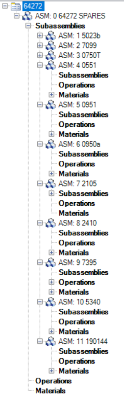

And just for fun, here is one more Job. This job is closed. :laughing:
