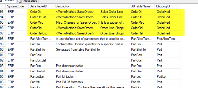

Also… The Data Dictionary description for ZdataTable.ChgLogID is:
Identifier value the system will use when creating Change Log records for this specific table (ChgLog.Indentifier) ChgLogID must be the same for a set of related tables. For example: Customer, ShipTo, CustBillTo, CustCnt, are all related and will have a ChgLogID = “Customer”. TIP: Using the tablename of the highest level parent table as the ChgLogID may avoid accidental duplication.
So shouldn’t all of the Update commands in that SQL script have set them all to have the same ChgLogID, instead of independent ones?
Here’s a query of the ZDataTable for TableID <> ChgLogID

I noticed that there were a few tables in zDataTable that are inconsistent so you raise a good point that I might bump into an upgrade issue later on. Seems like the “List” tables are some kind of temp table.
