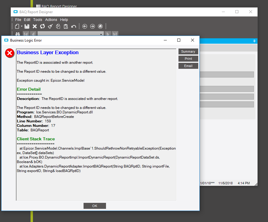

I am trying to import a BAQ Report and keep getting an error that states it is already associated. I have not other report with that name in the system. Any suggestions?
Can you import it if you specify a New Report ID?
If you have more than one company, possible the BAQReport ID already exists there?
I can create it with a new ID. The odd thing is if I search the BAQ Report there are no BAQ Reports with that ID. So not sure why it thinks there is.
What happens if you manually type the ReportID into the Report Designer instead of searching?
I’m pretty sure this has happened to me too - BAQReports and Dashboards
but I never investigated why
Just a guess… that a save was interrupted at some point.
- and a partial record was stored, ID in a related table?
same error
That is what I was thinking some is stored and not cleared out completely. I just created new and worked around it.
