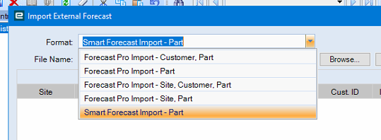

@Clambert here are the built in formats and they all are line by line.

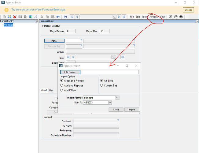

I agree with Melinda. Al the transforms and Excel-FOO need to be done in excell. You can actually bypass DMT and add into forecast vie Import Forecast from Forecast Entry . Then you get the options Clear and reload, Add and replace or Add If new. you can select Sites and a start date. Just need that flat file to import from…
