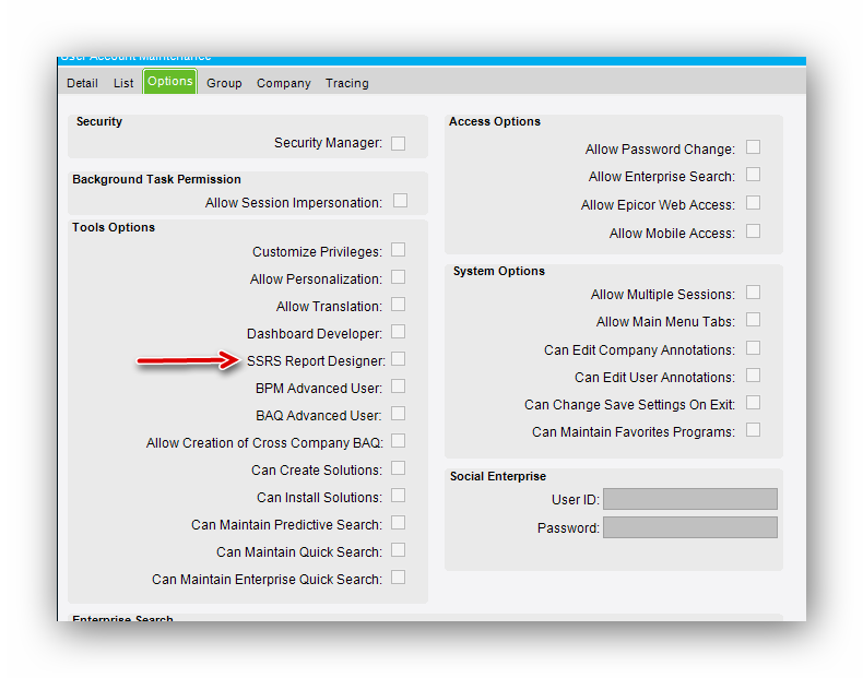

There’s a new option in User Account Security Maintenance that allows you to upload/download SSRS report styles. That’s what the error message is referencing.
Well if that wasn’t the simplest possible solution (no pun intended…).
Thanks, @tsmith! :slight_smile:
