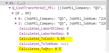

Input:
Output (I simply set ds2 = ds in my function)

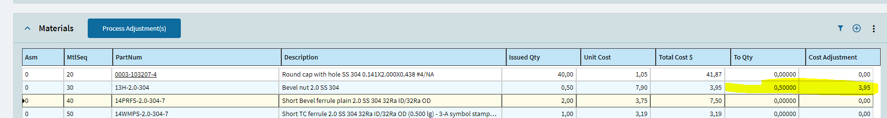

Here is what I entered in my grid:
