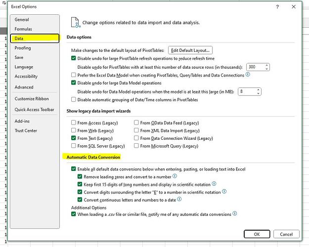

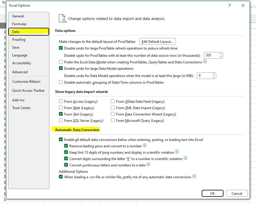

Curious if you have the same data settings as I do in Excel:
I don’t think it will help, but it is worth a look.
My version of excel has not been changed from default. It is excel 365.
